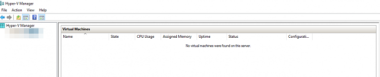

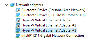

  3. ry4n Win User
    hyper-v virtual Ethernet adapter multiplying
    hello,
    every time i restart my computer a new "Hyper-V Virtual Ethernet Adapter" appears in my device manager. I've tried deleting/uninstalling and disabling them, but keeps replicating.
    Why do I have so many Hyper-V virtual ethernet adapters? How do I get rid of them? 197518d1532832492t-hyper-v-virtual-ethernet-adapter-multiplying-x2scrap.png
    I don't even have a VM running at the moment.

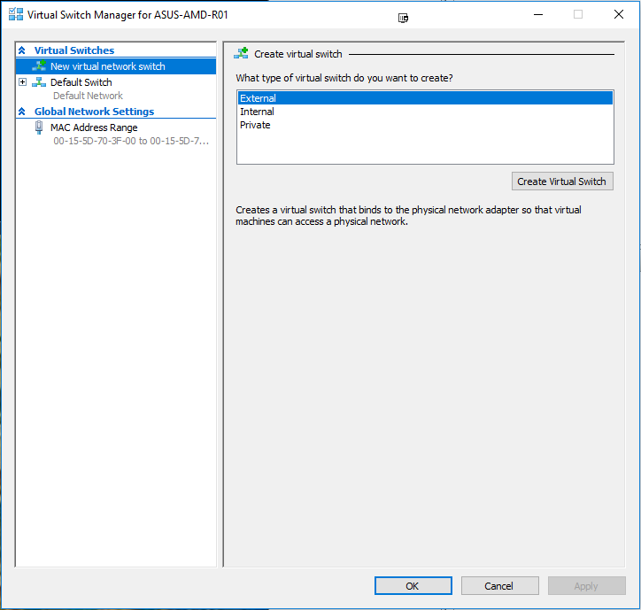

    Also, can't delete the default switch.
    Why do I have so many Hyper-V virtual ethernet adapters? How do I get rid of them? 197520d1532832950t-hyper-v-virtual-ethernet-adapter-multiplying-x2scrap2.png
    Thanks for help.
  4. cereberus Win User
    You cannot delete the default switch.
