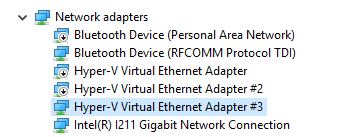

  1. Why do I have so many Hyper-V virtual ethernet adapters? How do I get rid of them?
    Hello,I occasionally test out things in virtual machines using hyper-v or windows sandbox, but I never have more than 1 vm at a time.However, when I go to device manager, under network adapters, I see that I apparently have 7 different hyper-v virtual ethernet adapters. I'm really not sure how and why I have this many, again I only have 1 vm set up.So, my questions are:1. Why do I have this many?2. Could they potentially impact my regular internet connection? it has been really slow recently for some reason3. Can I possibly get rid of most of them? I know I can't get rid of all of them becau
    Nelson Alex, Jan 21, 2023

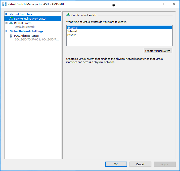

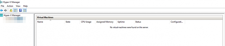

  3. ry4n Win User
    hyper-v virtual Ethernet adapter multiplying
    hello,
    every time i restart my computer a new "Hyper-V Virtual Ethernet Adapter" appears in my device manager. I've tried deleting/uninstalling and disabling them, but keeps replicating.
    Why do I have so many Hyper-V virtual ethernet adapters? How do I get rid of them? 197518d1532832492t-hyper-v-virtual-ethernet-adapter-multiplying-x2scrap.png
    I don't even have a VM running at the moment.
    Why do I have so many Hyper-V virtual ethernet adapters? How do I get rid of them? 197519d1532832654t-hyper-v-virtual-ethernet-adapter-multiplying-clipboardimage.png
    Also, can't delete the default switch.
    Why do I have so many Hyper-V virtual ethernet adapters? How do I get rid of them? 197520d1532832950t-hyper-v-virtual-ethernet-adapter-multiplying-x2scrap2.png
    Thanks for help.
  4. cereberus Win User
    You cannot delete the default switch.
    cereberus, Jan 21, 2023
