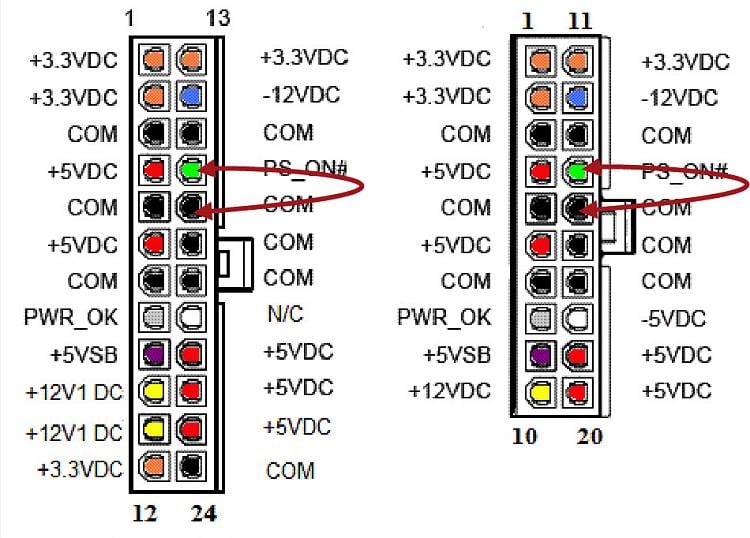

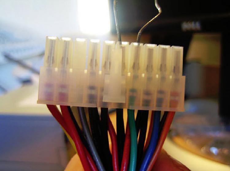

  4. topgundcp Win User
    Why is my pc dying when its turned off
    Dying PC
    To erase any doubt that it is actually the power supply went bad. Using a paper clip, see screen shot
    Shorten Pin 16+17 if you have a 24 pin power.
    Shorten pin 14 + 15 if you have 20 pin power.
    Plug the PSU to the electrical outlet, turn on the switch, it should power up then test it with either with a voltmeter or simply connect it to a fan. If they all work then it is nothing wrong with the PSU.
    NOTE: On the connector. The yellow + black wire ===> 12V DC
    Red + Black ====> 5V DC.
    topgundcp, Apr 1, 2023
