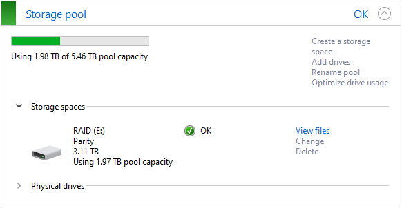

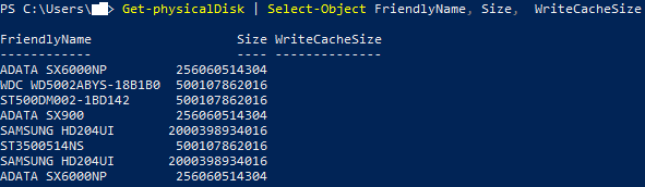

    I'm trying to set up storage spaces to use what I believe is called "write back cache". I originally had 1 SSD and 6 HDDs, I found it painfully slow. So I replaced one HDD with an SSD, and I added one more SSD.
    I'm trying to use the two Journal SSDs in the below list as the write back cache. I'm assuming I should see a value in the second image, but as you can see, it's blank.
    Any advice?

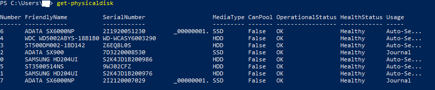

    They're all part of one pool
