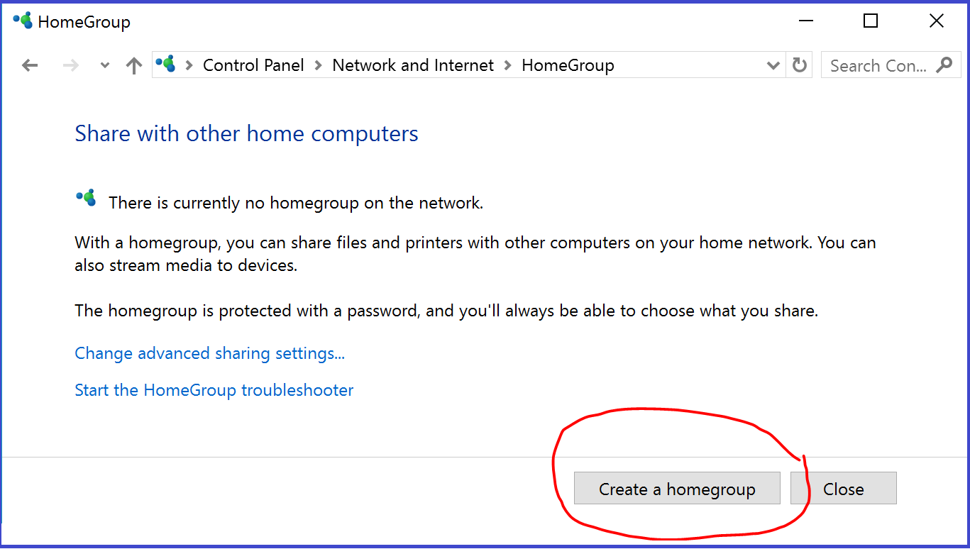

  4. Why is Roaming Running on a Homegroup Computer???
    No other homegroup PCs are available right now
    The Fix
    Create a brand new homegroup, because the existing one was corrupted.
    Steps
    On both computers:
    1. Leave the homegroup.
    2. Delete everything inside C:\Windows\ServiceProfiles\LocalService\AppData\Roaming\PeerNetworking.
    3. Turn off the computer.
    Now that both computers are off:
    1. Turn on one computer.
    2. Go to Control Panel > Network and Internet > Homegroup.
    3. Click the "Create a homegroup" button and follow the steps.

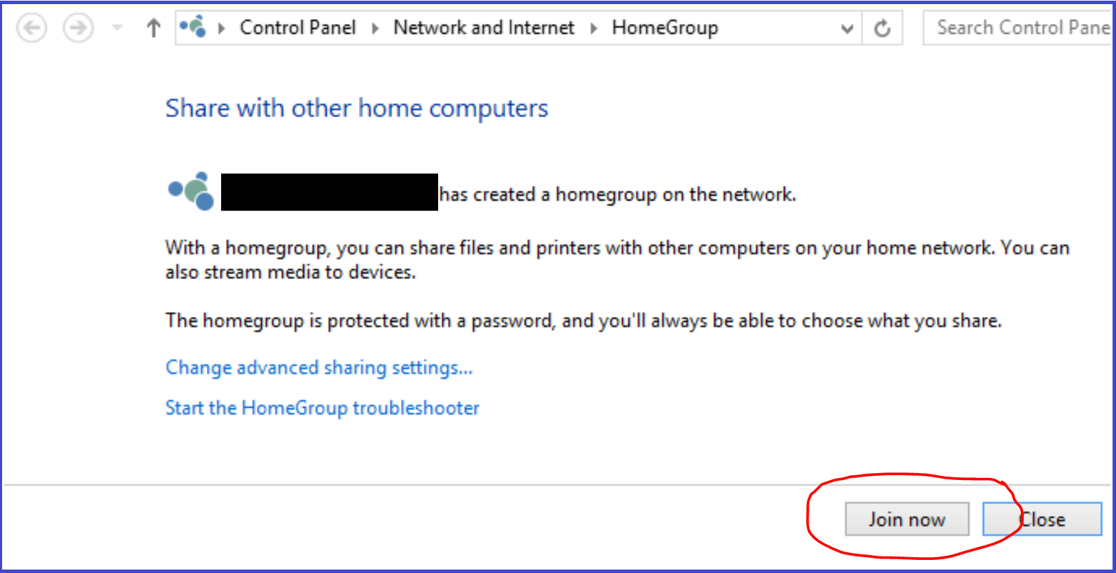

    Now that you have a new homegroup:
    1. Turn on the second computer.
    3. Click the "Join now" button and follow the steps.
