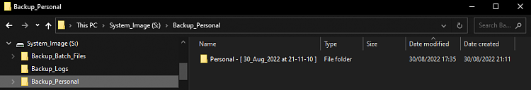

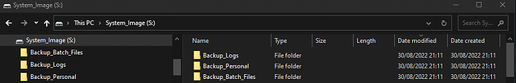

  2. Folder 'Date Modified' EARLIER than 'Date Created'
    I do NOT know how long this has been happening, but I just noticed it today. The problem appears to be related to just folders, and NOT files. When I create a NEW folder, the 'Date Created' and 'Date Modified' are the SAME. I have a Script that I created that I run once a day, or whenever I want, that backs up two folders with sub-folders. This has NOTHING to do with the Script, I am just using it as an example as it was easier to run in order to show what I mean. I have just run it [ 30-Aug-2022 at 21:11 ]. This shows the main folders, and the 'Date Created' and 'Date Modified' are the SAME. . . .
    Why is the date modified on a folder earlier than the date modified in that folder? 374230d1661890583t-folder-date-modified-earlier-than-date-created-image.png
    This shows the FIRST folder, and the 'Date Modified' is TWO days ago and about 11 hours earlier than the 'Date Created' . . .

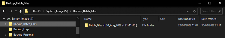

    The SECOND folder is just .log files and are OK. This shows the THIRD folder, and the 'Date Modified' is about 3.75 hours earlier than the 'Date Created' . . .
    Why is the date modified on a folder earlier than the date modified in that folder? 374233d1661890857t-folder-date-modified-earlier-than-date-created-image.png

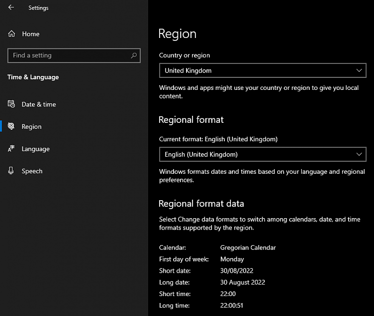

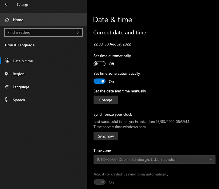

    The Date & Time shown in the folders above is CORRECT. The clock shows the CORRECT Date & Time for the UK.

  3. Folder 'Date Modified' EARLIER than 'Date Created'
    Hello @LesFerch,
    Brilliant, that is exactly what the answer is. I have just compared the original folders 'Date Created' and 'Date Modified' to the NEW folders 'Date Created' and 'Date Modified', and they tie up EXACTLY. I am using Robocopy by the way. Solved. Thank you. *Thumbs

  4. LesFerch Win User
    The Date accessed registry values have nothing to do with it. I can replicate what you're seeing by copying a folder that has a Date modified value that is earlier than today to another disk using a command such as Robocopy C:\SomeDir D:\SomeDir /mir. The destination folder will have the old Date modified date, but today's date for Date created.
