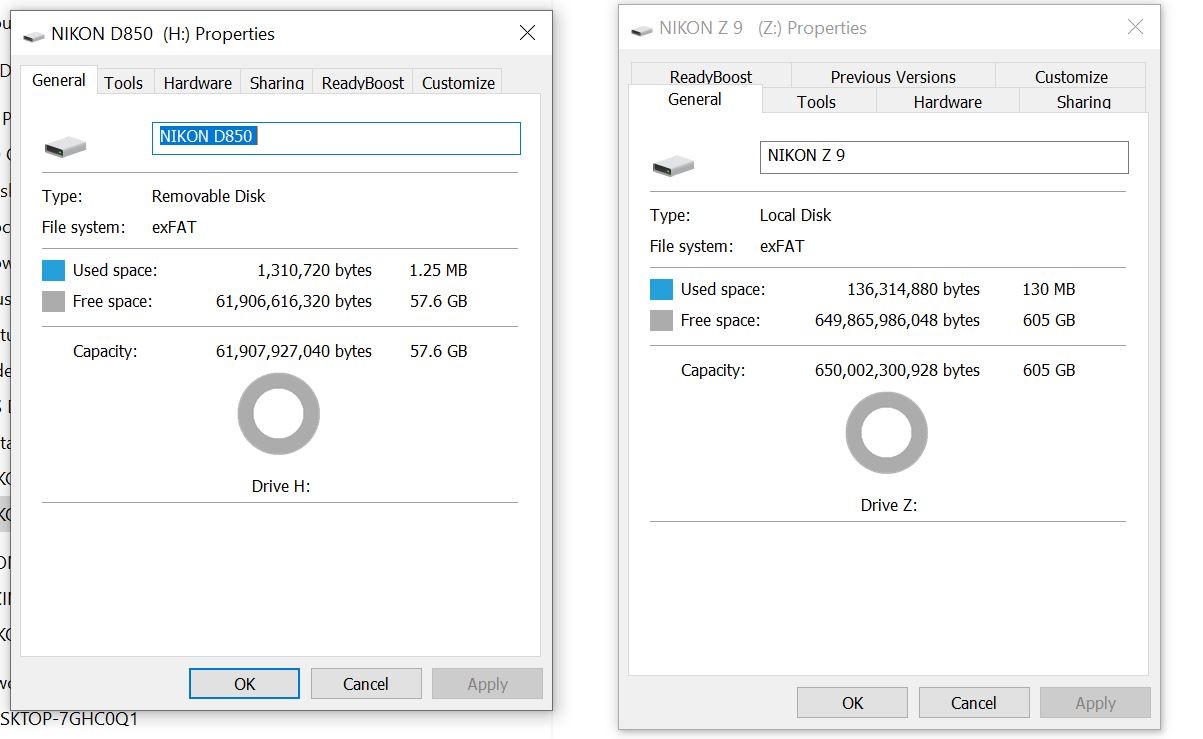

    Card Properties (SEE IMAGES)
    The SD Card Slot shows the Card Type to be REMOVABLE
    The CF Express show the Card Type to be LOCAL
