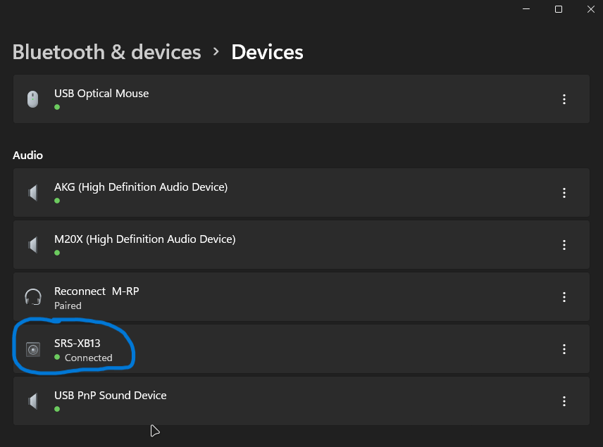

    i have a Sony SRS-XB13 Bluetooth Speaker that i want to connect to my PC, although it says it's connected in the bluetooth pannel :-
    Why my Sony SRS - XB13 Bluetooth Speaker is not recognised by my Windows 11 ? 078990ac-a046-4b1d-b84f-9e98d77a6e48?upload=true.png

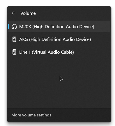

    But nothing is showing up in the sound device selector pannel related to it so, no sound is coming from the Speaker :-
    Why my Sony SRS - XB13 Bluetooth Speaker is not recognised by my Windows 11 ? 1c4e0f84-0a49-4b18-95ee-03810a831633?upload=true.png

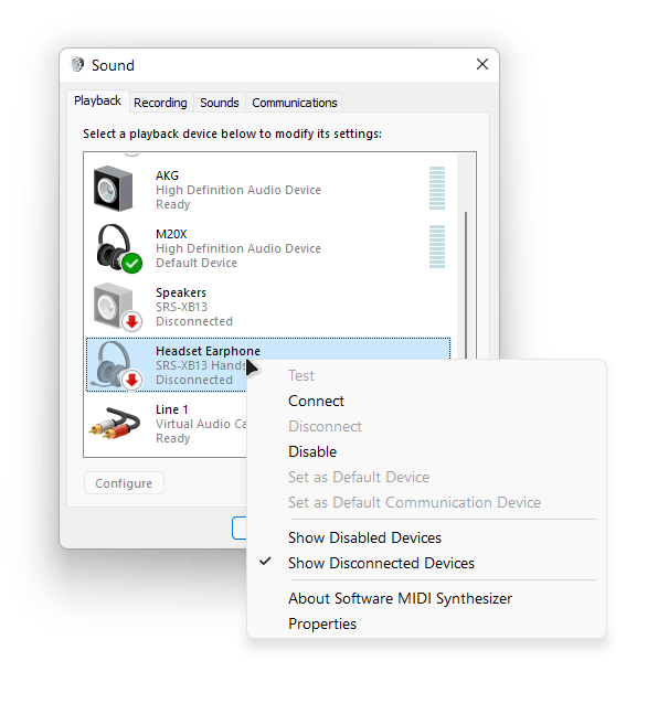

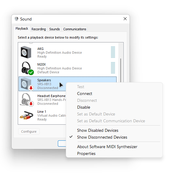

    I then looked up in the Advanced Sound Control Pannel and this is what it says:-
    Why my Sony SRS - XB13 Bluetooth Speaker is not recognised by my Windows 11 ? 6cdd8c96-c981-4952-a38e-9baa6e357597?upload=true.png
    Why my Sony SRS - XB13 Bluetooth Speaker is not recognised by my Windows 11 ? 34c66ce6-f052-4949-8df1-936a9e2aaef6?upload=true.png
    I then Clicked Connect for both of them but nothing appears to happen

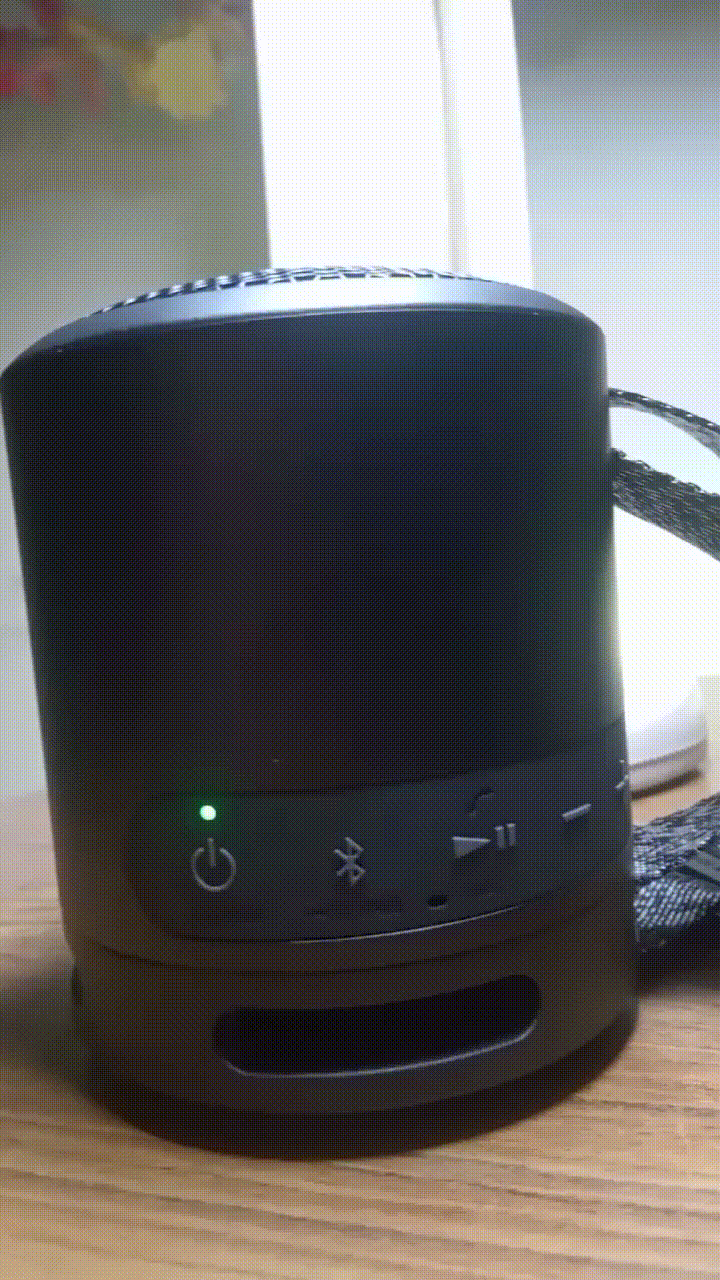

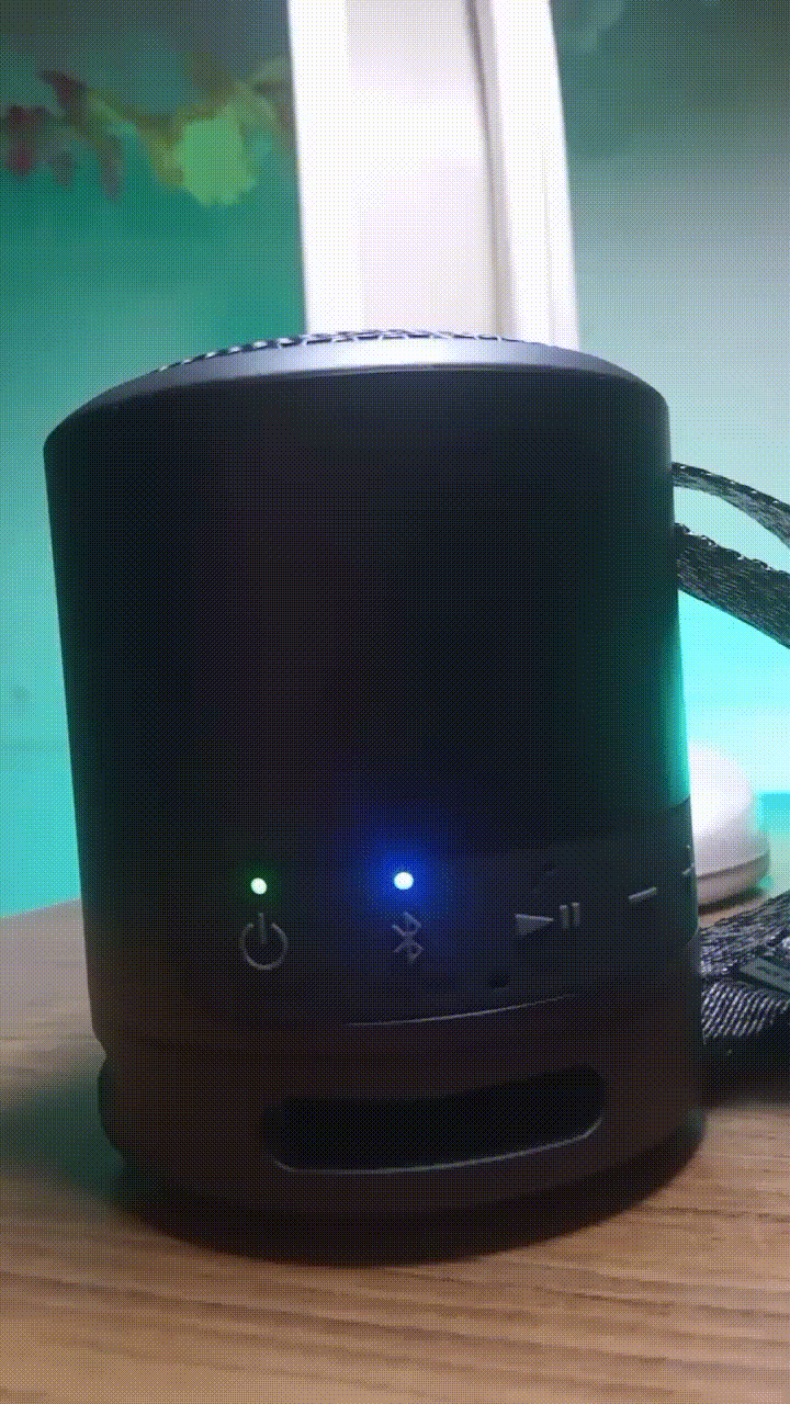

    the speaker was able to connect with my smarthphone while giving sound output also i observed when it was connected to my smartphone, it gave a consistent blue light indicator but when it was connected to my PC, it gave a blinking blue light indication that means when it's actually ready to give sound output, it shows a consistent blue light in case of my smartphone
    This is in case of my PC Connected to it :-

    And this is in case of my Smartphone is connect to it :-
    Why my Sony SRS - XB13 Bluetooth Speaker is not recognised by my Windows 11 ? 341b29a9-4179-41d6-b309-46b57b26b7a3?upload=true.gif
