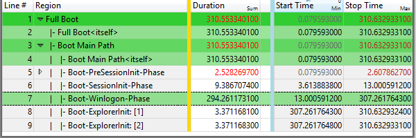

    My laptop is Inspiron 5559, 8GB RAM, 1TB HDD. My laptop is very slow to boot up I know HDD is slow but is this still normal? I already tried the steps here https://answers.microsoft.com/en-us/windows/forum/windows_10-performance/slow-boot-on-windows-10/83d7e818-6511-4789-91fd-38449fcc4615 but nothing changes. So I searched more to see how my machine works while booting up and I found this Windows Performance Toolkit.this is the result:I don't if this is normal. Also, I noticed that the disk is working really hard while booting up while the CPU and memory are running normallyI don't know h

    Startup takes too long at Winlogon Init
    Your boot trace shows that your logon phase took 31s, and 26s was spent loading your user profile.

    Windows 10 - Slow winlogon boot phase on SSD
    According to Windows Performance Recorder,
    my Winlogon phase is taking 290 seconds to complete:
    This thread suggests that it is a HDD bottleneck, but my OS is installed on a 240 GB SSD from Kingston. So I believe something else might be the problem. Any ideas? I have a secondary HDD, but I already tried to boot without it plugged in and the issue persists. Also, my SSD is half empty, so that shouldn't be a problem.
    **Edit:
    I´ve tracked a few misbehaving processes. Here are some that i think might be the problem. Note how the wermgr.exe process finishes at 159 seconds. Then the sppsvc.exe process starts (likely due to a dependecy) and then the sppsvc.exe process ends at 191 seconds, roughly the end of my winlogon phase. (I've done another WPR trace and the winlogon phase took 192 seconds, just as a FYI).
