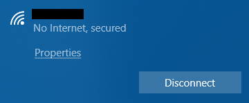

  3. Gunnart48 Win User
    WiFi not automatically disconnecting when out of range
    My problem is that my laptop won't disconnect from a WiFi network when out of range unless I actually click the disconnect button. For example, if I go to my friend's house (several blocks away) and open my laptop, it still appears to be connected, just with no internet (see below).
    WiFi often disconnecting and unchecking "connect automatically when in range"? 192158d1528903960t-wifi-not-automatically-disconnecting-when-out-range-noautodisconnect.png
    I can't seem to find any info on why this could be happening or how to fix it. Any help with solving this would be greatly appreciated.
