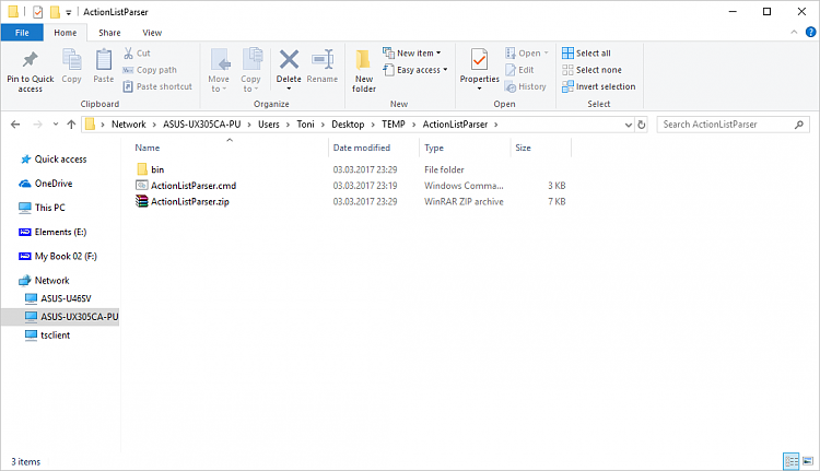

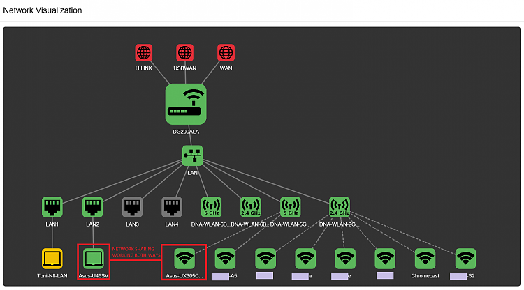

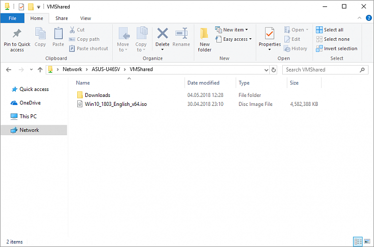

    Alright, here goes:
    1. Navigate to Settings > Network & Internet > Status > Change Connection Status
    2. Make sure your network is set to Private
    3. Also make sure you have NOT made the connection Metered
    4. Next navigate to Settings > Network & Internet > Status > Network and Sharing Center
    5. This will open up Control Panel > All Control Panel Items > Network and Sharing Center
    6. Click Change Advanced Sharing Settings and under Private set Turn on Network Discovery and check the box Turn on automatic setup of network connected devices(optional)
    7. Turn on File and Printer Sharing
    8. On Guest or Public have everything turned OFF
    9. Under All networks turn off Public folder sharing, select Use 128-bit encryption and Turn on password protected sharing if you want to have added security, else turn it off and everybody should have access to all your shares without any passed user credentials.
    If you choose to use password protected sharing, then there are additional steps to take. Please let me know and we continue this further.
    Here are a few screenshots:
    slicendice, Sep 9, 2023
