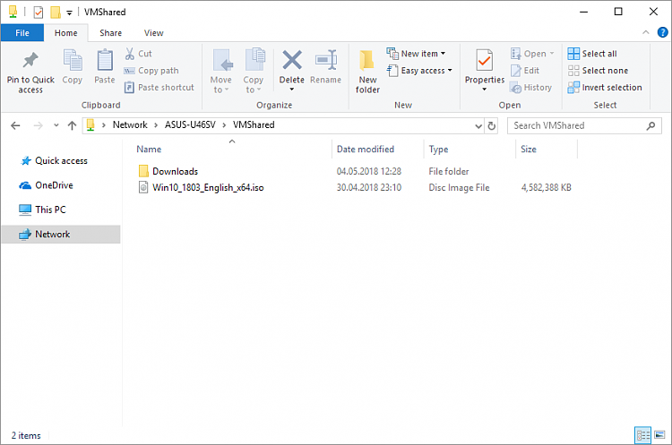

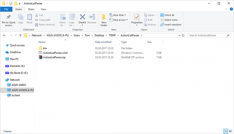

    Here are a few screenshots:
    slicendice, Sep 9, 2023
