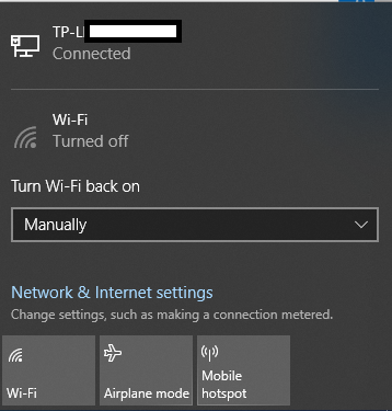

    hi to all, I am facing issue in windows 10 after updating, I connect ethernet cable to my laptop. and create hotspot from it. but after update I am facing issue, when I plug ethernet cable in laptop. it turn off my wifi, I want to use both at same time ethernet cable for internet and wifi for hotspot.
    I click on turn on, but it auto disable again. I have tried to change priority of connection. and other solution. but still same issue
    wifi turns off when i pluged ethernetcable 860ed2bd-3cb8-447e-81be-c4cb5ac0e8a2?upload=true.png
    FarrukhRehman, Sep 25, 2019

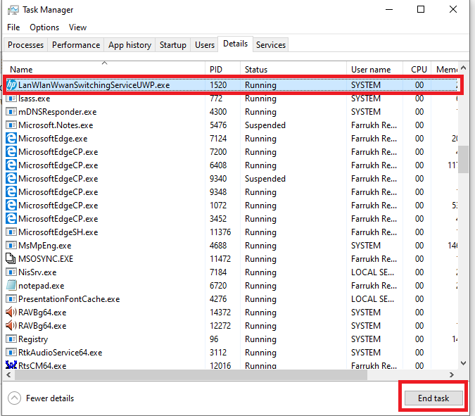

    I found a solution it was due to "LanWlanWwanSwitchingServiceUWP.exe" I am using HP ProBook 450 G2. and I found this exe file running in task manger I just kill this exe. and try to on wifi and create hotspot it start working.
    wifi turns off when i pluged ethernetcable 3d21feb4-9818-46bf-98a8-0a08e96dab26?upload=true.png
    FarrukhRehman, Sep 27, 2019
