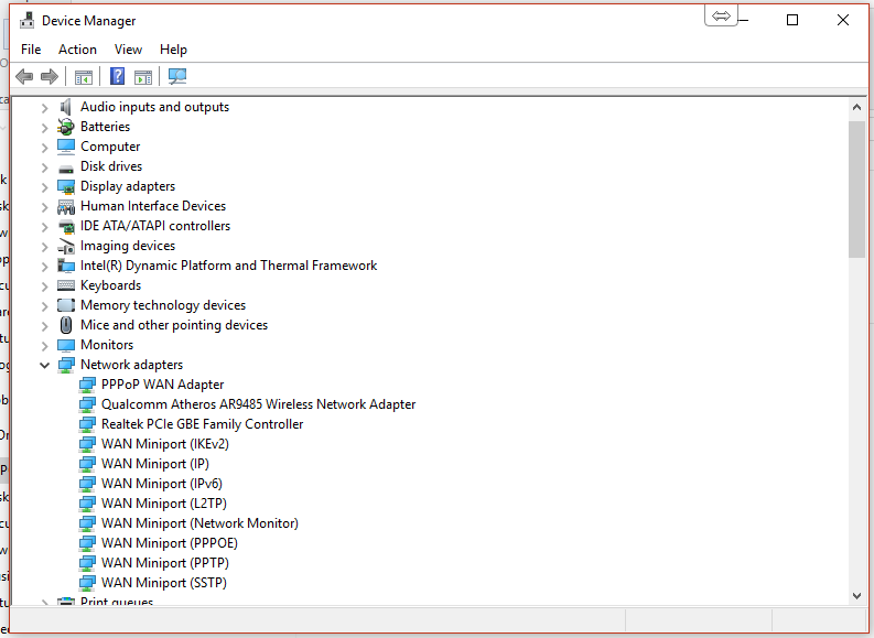

    Not sure where I have to put this but it's annoying the hell out of me. Whenever I try to download a file form the internet or from P2P network my wifi connection just drops and won't reconnect again until I reboot my laptop.
    I've tried multiple things but so far came up zilth.
    What I have tried
    • Updating WiFi driver
    • Disallow power management to shut down adaptor
    • Checked the bandwith connection from the internet. Fast enough and it isn't saturating the connection
    • winsock reset
    • tried booting in safe mode - > no result
    I'm running out idea's.. Anyone else have an idea ?
    Network Adapaters
    Nicolas Pierre, Nov 27, 2020
