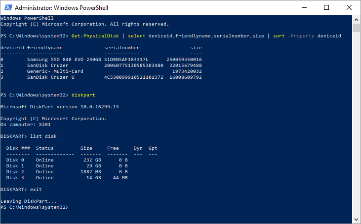

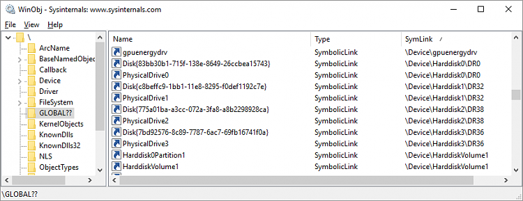

    I can't run diskpart in Powershell - I'm not familiar with Powershell, but diskpart just opens up a command window when I type it in Powershell.
    But I might have it matched up using Get-PhysicalDisk:
    In Powershell, I have 3 drives listed under deviceid:
    deviceid
    0
    1
    2
    And in WinObj I have 3 physical drives listed - DR0, DR1 and DR2.
    My main HDD is listed for deviceid 1 in Powershell, and my USB thumb drive is deviceid 2. So I'm guessing DR1 in WinOBj = deviceid 1 in Powershell? If so, then that's my main HDD. I was hoping the bad block was just my thumb drive.
    rivre, Feb 1, 2024

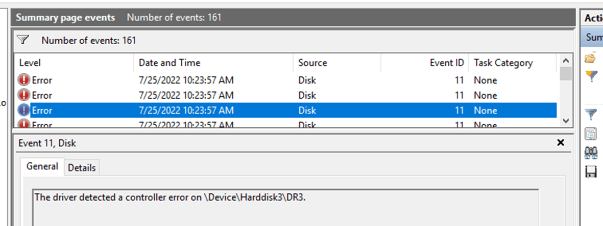

    The driver detected a controller error on \Device\Harddisk1\DR1
    Hello
    I'm using Windows Server 2022 and I have this problem: The driver detected a controller error on \Device\Harddisk1\DR1
    Here is the description of my environment
    2 physical server with Windows Server 2022. Holding hyper V role and high availability cluster
    Shared FC HPE storage
    I have carted 3 VMs windows server 2019 to the hyper V ( first on node 1 and 2nd , 3rd on node 2)
    Install SQL 2019 cluster on all 3 VMs. Data drive is created as VHD SET and that is reside on shared clustered volume
    Everything is working fine but getting following error in the event viewer on the 2 passive nodes not in control of the disks produce. The 3rd VM where the disks active no error.
    The driver detected a controller error on \Device\Harddisk1\DR1. Event ID 11
    WIN 11 - I keep getting this error, how to fix. "The device, \Device\Harddisk1\DR1, has a... 136283a4-376d-42ba-8de3-181ebf729972?upload=true.png
    Can anyone help
    Mukesh Yadav1, Feb 1, 2024
