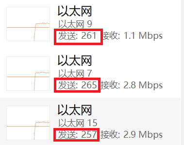

  3. nfsking Win User
    Win11 2H22 SMB Multichannel copy speed slow
    According to the release note, Windows 11 22H2 has a known issue which will cause the SMB multichannel copying speed limited under 1Gbps:
    September 30, 2022—KB5017389 (OS Build 22621.608) Preview - Microsoft Support
    But the release note only mentioned as "You are more likely to experience this issue copying files to Windows 11, version 22H2 from a network share via Server Message Block (SMB)", which meant the speed of copying files from Windows 11 to a SMB server (uploading) would not be affected.
    Some other users reported that the copying speed from a 3x1Gbps NICs PC to a SMB server could be kept at full speed:
    SMB copy limited to 700mbit after 22H2 update - Microsoft Community
    But in my case, the file copying speed from a 3x1Gbps NICs PC to SMB server has also been limited:
    WIN11 KB5036980 breaks SMB Multichannel 83a07591-6ad1-499c-b837-66da189fa5ac?upload=true.png
    The upload speed of each NIC has been limited under 270Mbps and in total of 810Mbps.
    On the same PC, if there are only 2 NICs installed, the copying speed will be as expected (2Gbps).
    So is this problem also caused by the known issue introduced by 22H2, or it's a new issue? Or it is caused by the wrong configuration on my PC?
    BTW, the workaround provided in the release note did not work at all, the speed would still be limited with xcopy or robocopy /J command.
    nfsking, Apr 30, 2024
