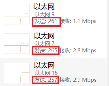

    But in my case, the file copying speed from a 3x1Gbps NICs PC to SMB server has also been limited:
    WIN11 KB5036980 breaks SMB Multichannel 83a07591-6ad1-499c-b837-66da189fa5ac?upload=true.png
    The upload speed of each NIC has been limited under 270Mbps and in total of 810Mbps.
    On the same PC, if there are only 2 NICs installed, the copying speed will be as expected (2Gbps).
    So is this problem also caused by the known issue introduced by 22H2, or it's a new issue? Or it is caused by the wrong configuration on my PC?
    BTW, the workaround provided in the release note did not work at all, the speed would still be limited with xcopy or robocopy /J command.
