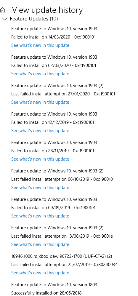

  1. jehilton Win User
    Window could not configure one or more components...What am I doing wrong?
    I repeatedly get this error, and it takes forever to get to the fail point, i am seriously considering a mac at this point
    Window could not configure one or more components...What am I doing wrong? f037efdc-c8b6-4da7-ba2a-16e755b657d7?upload=true.png
    jehilton, Mar 15, 2020

  4. Allan Mej Win User
    Creator's Update reaches 40% and the following error message appears Windows could not configure one or more system components. To install Windows, . . .
    This issue happens because of some errors or corruptions in Windows Update components. To fix this kind of issue, we suggest
    Resetting Windows Update components. To do so, follow these steps:
    • Right-click the Start Menu and open Command Prompt (Admin).
    • Run these codes:
      Net Stop bits
      Net Stop wuauserv
      Net Stop appidsvc
      Net Stop cryptsvc
      Ren %systemroot%\SoftwareDistribution SoftwareDistribution.bak
      Ren %systemroot%\system32\catroot2 catroot2.bak
      Net Start bits
      Net Start wuauserv
      Net Start appidsvc
      Net Start cryptsvc
    • After running these commands, check if your issue is fixed.
    If resetting Windows Update components didn't work too, we suggest you to identify and send us the error. To do so, follow these steps:
    • Open Settings and click on Update & security.
    • Click on Windows Update.
    • Click the Advanced options link.
    • Click the View your update history link.
    • Click the link for the update that failed to install, note the error code and give us the error code.
    We'll be looking forward for your reply.
    Regards.
    Allan Mej, Mar 15, 2020
