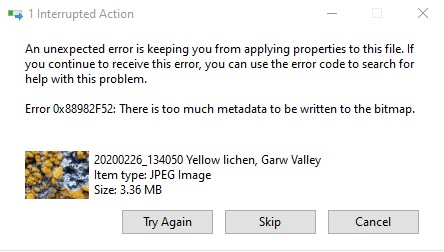

    There have been many posts about this problem here and elsewhere over several years - but it persists. It is a big and frustrating issue for those of us who spend a lot of time on photos. I don't know if there is a will to fix it or not, but assuming there might be, I will give the scenarios I can.
    As you know, the error occurs when trying to give a rating, or add a tag, to a photo or video. In fact, in the current Windows 10, unfortunately you can't rate or tag videos at all, so that's all there is to say about videos; the rest mainly applies to photos which will be filetype .jpg.
    The error will occur for that file whether the rating is applied in File Explorer directly, or via the Properties-Details pop up, or in other panels. There is no work round I can find - if you copy the file or resize it, the new file will have the same error. You can take a screen snip and create a new image that can have properties changed but that loses so much quality. The photos can come from any make/model of digital camera, judged by people reporting for many phone manufacturers. I have experienced it recently with images originating from Samsung Galaxy S6 and S9+ among others.

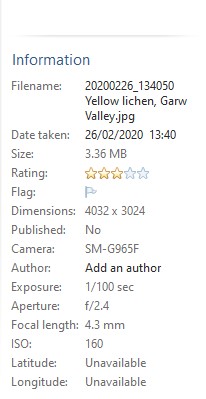

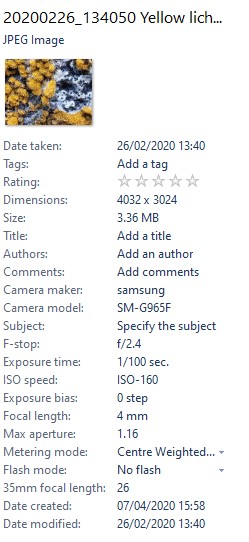

    They may have been rated, apparently successfully, in Gallery, but when viewed in File Explorer the rating has gone. However, if reopened in Gallery, the rating is still there. I'll add a screen shot at the end for the same file that gave the error I posted already, showing rating with Gallery but not in File Explorer. I'll add a screen shot at the end for the same file that gave the error I posted already, showing rating with Gallery but not in File Explorer. Similarly, if the photo was never rated in Photo Gallery but gives an error in File Explorer, the rating can apparently be added in Gallery but does not show in File Explorer.

    File viewed in Gallery - note rating.
    Windows 10: "0X88982F52 There is too much metadata to be written to the bitmap" 7700605a-bdb3-4a65-a116-dfff0fb89d72?upload=true.jpg
    File viewed in File Explorer - rating gone and will give the error we started with if we try to add it.
    Windows 10: "0X88982F52 There is too much metadata to be written to the bitmap" 7f25d018-64a1-413f-b66e-b3792fb491dc?upload=true.jpg

  2. Picture metadata edit error 0x88982F52
    Hi, I have a problem with editing picture metadata in Windows 10 (updated).
    When I try to save for example edited rating on picture in File Explorer I get error message:
    "Error 0x88982F52: There is too much metadata to be written to the bitmap."
    I don't have problem with every picture taken by Huawei P10 stock camera, just about 1/3 of them.
    ExifToolGUI also shows warning to all pictures taken by Huawei P10: "Warning: [minor] Unrecognized MakerNotes"
    Is it bug in Huawei stock camera app or in DirectWrite (Error 0x88982F52 | WINCODEC_ERR_TOOMUCHMETADATA - HRESULT.info)?
