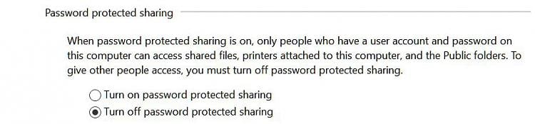

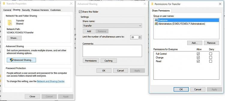

    So changing computer names for discussion purposes I bought a NewDesktop running Windows 11 and tried to setup file sharing with my OldDesktop and OldLaptop.Despite walking through all the file sharing guides I could find, setting up shared folders with full read/write access to everyone and turning off password requirements in advanced network settings - I could see and access the shares on my Old PCs, and see the shared folder on my NewDesktop, but trying to access the NewDesktop shared triggered a name/password pop up and repeated Credentials Not Recognised messages.The only solution I co

  4. Windows 10/11 Shared Folders Not Recognising Credentials, a Solution.
    Win 10 PC accessing a Win 10 Everyone share prompted for credentials
    Here is the solution for this issue :
    1 Right click on the folder that you want to share
    2. Go to Properties
    3. Go to Security Tab then click Edit on group and usernames
    4. Click Add and on the user and group window click advance
    5. Click Find Now and look for Everyone on the Search results, Click OK to close the window and OK again
    6. Give the control you need for Everyone and click "OK"
    That should make that folder accessible without prompting for windows credentials Windows 10/11 Shared Folders Not Recognising Credentials, a Solution. :)
    jeremygoce, May 10, 2024
