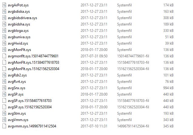

    As mentioned in several threads the most likely cause is a driver incompatibility. This was the case for me as well, but not a hardware driver, rather it was the drivers installed by the AVG antivirus software. These drivers should have been removed when I uninstalled AVG some years back, but was not (and yes - I have run the AVG_remover software repeatedly but without effect).
    You can find find if this is the origin of your problems via running a kernel dump analysis, but that is a bit tricky, so instead: if you know you have had AVG installed, have a look in the C:\Windows\System32\drivers folder. If you see old files starting with avg like this:
    Windows 10 1803 Update Error 0xc1900101 - possible error and resolution 1eb376bd-ba10-4f19-ada6-7f0b34fea5df?upload=true.jpg
    ...then you most likely have the same problem as I did. No guarantee, but if it helps someone then good.

    3. Once in safe mode go to the C:\Windows\System32\drivers folder and move the avgXXX.sys files to another folder (or delete them).

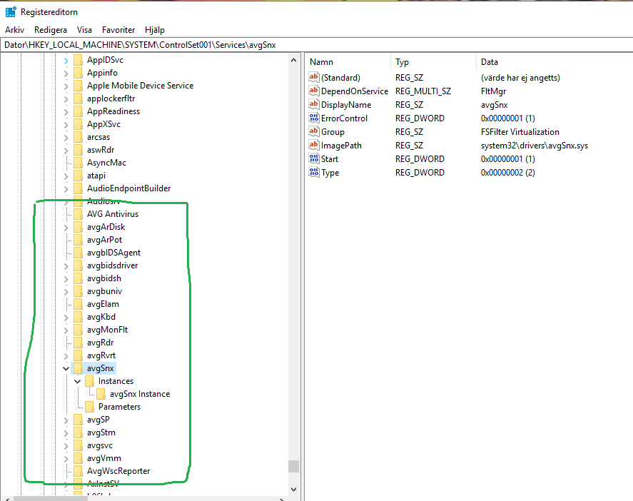

    4. Open regedit and search for AVG and remove ALL RELEVANT ENTRIES (AND ONLY THOSE!!). This is the critical one - which are the relevant entries? Well, I can´t say for sure... I removed everything that I could judge had anything to do with AVG Antivirus - basically anything that mentioned a path like C:\...\AVG\..., or had a value that contained AVG srl (the company name) as well as all the entries for the drivers shown in the picture above, but its very likely that its enough to just remove the driver entries. This is how the corresponding driver entries looks in the registry:
    Windows 10 1803 Update Error 0xc1900101 - possible error and resolution 652dd526-f465-4c15-808d-be20a1c1a205?upload=true.png
    So either you just remove those and boot windows back into normal mode (described on the same page that showed how to boot into safe mode - see the link above) and retry the update or you delete (using your sound judgement) everything that clearly has somehing to do with AVG (and there are alot of them - the registry is littered with AVG stuff).
    After performing those steps Windows had no problems updating itself to 1903.
