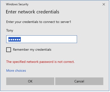

    I have a small home network with four Windows 2000 Servers SP4 running. Since moving to Windows 10 1909 I can no longer map a network drive from the servers.
    The error I get is:
    Windows 10 1909 Can Not Connect/map drive to Windows 2000 Server SP4 03aca503-2806-4a0c-96fe-f51ad9addd10?upload=true.jpg
    I have a Windows XP computer on a KVM switch and it logs in fine so I know the password is working.

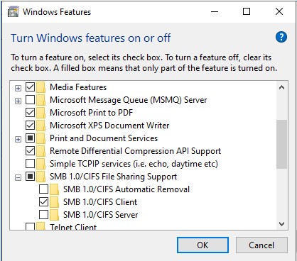

    I set SMBv1 as active in the Windows 10 computer:
    Windows 10 1909 Can Not Connect/map drive to Windows 2000 Server SP4 ceb41b2a-380d-49fc-935c-79a440c83ff1?upload=true.jpg
    I suspect that the issue is that the Windows 10 computer is using NTLMv2 and the Windows 2000 Server is using LM and NTLM thus the password error.
    How do I force the Windows 10 computer to use LM and NTLM protocols?
    I think it's in REG key HKLM\System\CurrentControlSet\Control\Lsa\LmCompatibilityLevel . My Windows is lacking a LmCompatibilityLevel entry which I think should be 0.
    Before I add it I thought I would check here first.
