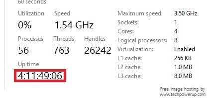

  3. AsRock Win User
    [Solved] Windows 10 and the shutdown button
    Well i always use the shutdown button and apparently Win10 Pro don't actually shutdown unless you turn off hibernation, well i don't want to do that, i just want the shutdown do just what it should shutdown and hibernation to to do just that lol.
    So anyone know the reg key or if there is some thing in the administrative tools that makes shutdown mean just that ?.
    What i have noticed is when your on a upgrade from win7 some times it shutdown and some time's it hibernated how ever this is not the case with a fresh install of Win10.
    I believe this is a option that spawned in with Win8 and has carried over to win 10.
    Windows 10 cannot hibernate or hybrid shutdown after installing version 2004 - volmgr,... uptime.jpg
    AsRock, Aug 28, 2020
