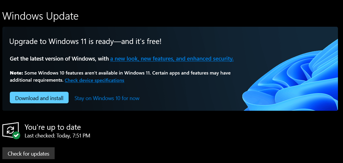

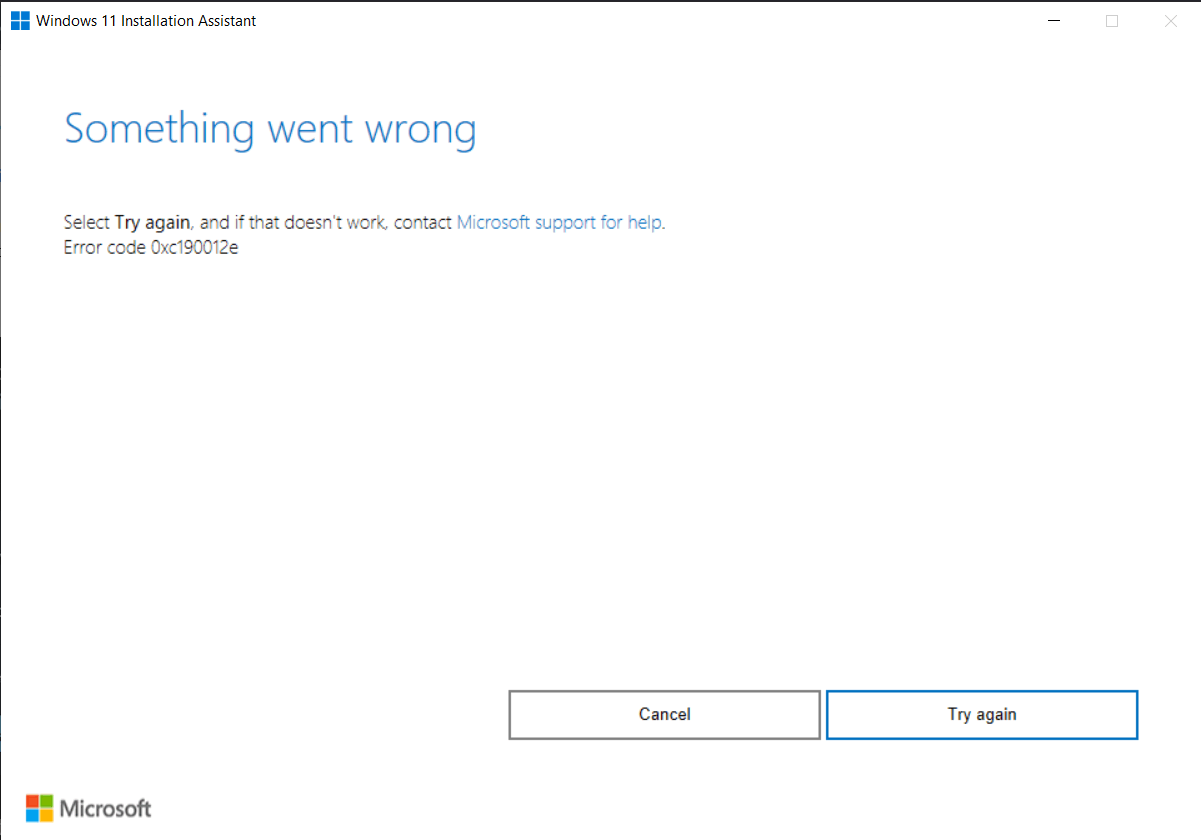

  4. Windows 10 download of upgrade to Windows 11 fails with error 0xC190012e
    Error upgrading to Windows 11 (0xc190012e)

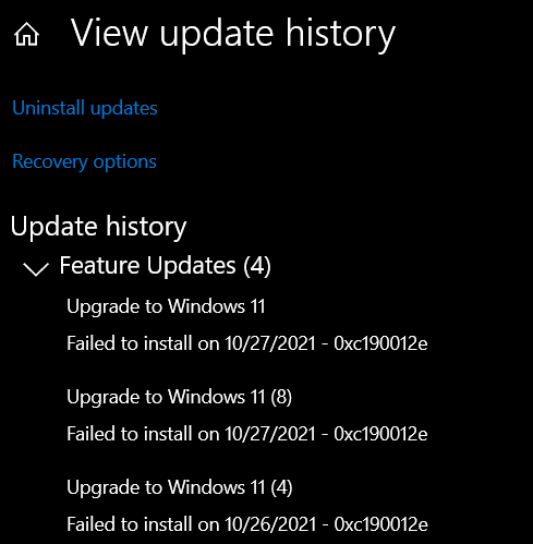

    I finally received the prompt through Windows Update to upgrade to Windows 11. Unfortunately, when I click on "Download and install", after the download gets to about 7%, this "Status" line will disappear, bringing back the "Upgrade to Windows 11" prompt, as if I had never clicked "Download and install". With the fact that there is no error code, no clue at all as to what is causing an error during the download / installation of Windows 11, I then tried upgrading through something other than Windows Update. I downloaded the Windows 11 Installation Assistant from here ( https://www.microsoft.com/en-ca/software-download/windows11 ) and I think it gives some more information. The download / installation still stops at around 71%, step 3 of 3, but it gives me the error code 0xc190012e afterwards. I can't find anything about this error, other than generic tips to resolve it (running the System File Checker, running the Windows Update Troubleshooter, which I did, but they don't solve the issue). I don't know how to get PC Health Check to show me that "You meet all the requirements" prompt again, but it did tell me I met all the requirements when I first opened that app. Anyone knows how to solve that issue and upgrade to Windows 11?
    [EDIT] Windows Update does show the very same error code if you go to "View update history".
