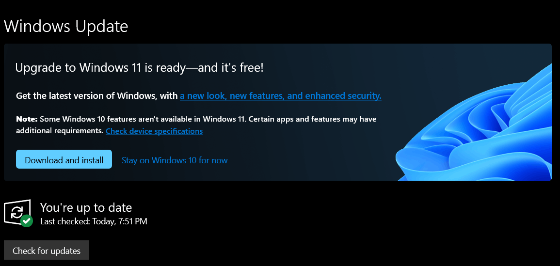

    Edition Windows 10 Pro Version 22H2 Installed on ‎17/‎06/‎2020 OS build 19045.3208 Experience Windows Feature Experience Pack 1000.19041.1000.0 Windows 10 informs me that I can "Download and install" the upgrade to Windows 11, version 22H2.When I do this or retry it gets to 6%, jumps to 8%, and then the upgrade text disappears.When I refresh by checking for updates, it shows:

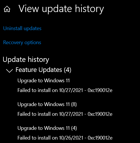

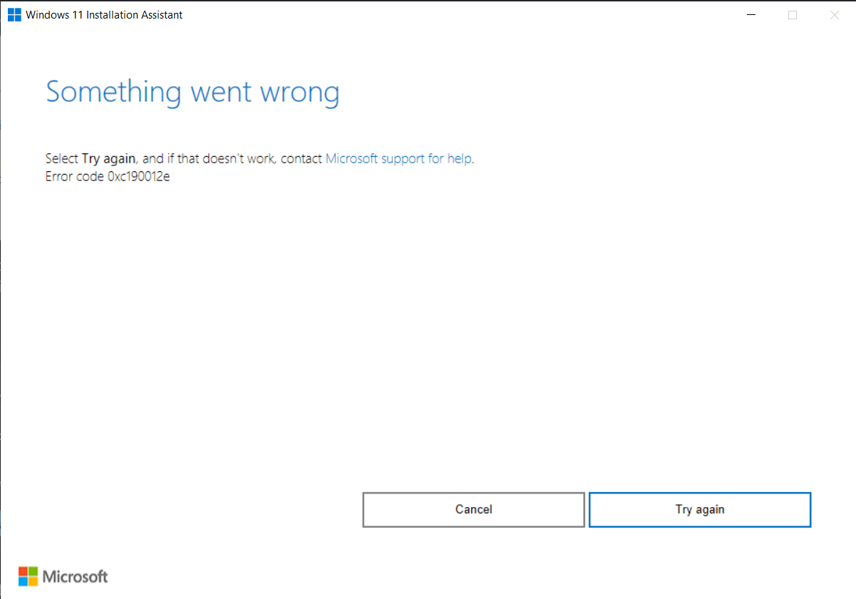

    I finally received the prompt through Windows Update to upgrade to Windows 11. Unfortunately, when I click on "Download and install", after the download gets to about 7%, this "Status" line will disappear, bringing back the "Upgrade to Windows 11" prompt, as if I had never clicked "Download and install". With the fact that there is no error code, no clue at all as to what is causing an error during the download / installation of Windows 11, I then tried upgrading through something other than Windows Update. I downloaded the Windows 11 Installation Assistant from here ( https://www.microsoft.com/en-ca/software-download/windows11 ) and I think it gives some more information. The download / installation still stops at around 71%, step 3 of 3, but it gives me the error code 0xc190012e afterwards. I can't find anything about this error, other than generic tips to resolve it (running the System File Checker, running the Windows Update Troubleshooter, which I did, but they don't solve the issue). I don't know how to get PC Health Check to show me that "You meet all the requirements" prompt again, but it did tell me I met all the requirements when I first opened that app. Anyone knows how to solve that issue and upgrade to Windows 11?
    [EDIT] Windows Update does show the very same error code if you go to "View update history".
    Thanks so much
