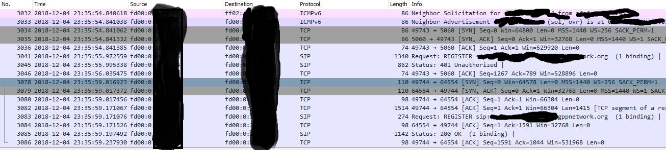

  2. SusRaj Win User
    3 Second Delay in TCP SYN for the IPSec in Windows 10 compared with Windows 7
    I am facing a strange issue with the TCP connection in Windows 10 compared with Windows 7. I am observing a delay of 3 seconds while establishing an IPSec connection in Windows 10, while in Windows 7, the connection is established in milliseconds. I was
    surprised to see that the changing the InitialRTO from 3 seconds to 1 second reduced the connection establishment time from 3 seonds to 1 second in Windows 10. Obviously Windows 7 is not having InitalRTO TCP parameter and I am not sure how much is the default
    being set in Windows 7. So, my issues is, the extra delay in Windows 10 is causing problems in existing scripts and need the reason for the delay being introduced in the Windows 10.
    A detailed step by step problem statement is provided below;
    · I am testing scenario using SIP (Session Initiation Protocol) server and SIP client. SIP server always running on Windows 7, while SIP Client need to be upgraded from Windows 7 to Windows 10.
    · The first TCP connection between SIP client to SIP server is established (3 way SYN handshake)
    · SIP Client sends REGISTER message with IPSec requirement to SIP server.
    · SIP server responds with “401 Unauthorized” with server details for establishing an IPSec connection
    · SIP client tries establish a new IPSec connection with SIP Server
    o My code calls the
    connect immediately after getting the Server Response, with new connection details.
    o The first Encrypted packet SYN to server is sent by the Windows only after 3 Seconds in Windows 10, while the same SYN is sent out within few milliseconds in Windows 7.
    o Changing InitialRTO from 3 Seconds to 1 second will help Windows 10 to send the encrypted SYN faster.
    I would like to know why this delay is introduced in Windows 10? Why changing the Initial RTO from 3 Seconds to 1 Second, changes the time required to send a SYN?
    Even though the RFC 6298 asks to change the Intial RTO to 1 second from the old 3 seconds, why Windows 10 is keeping the same in 3 seconds.
    Thanks
    Susanth
    see the packets 3045, 3046 and 3078
