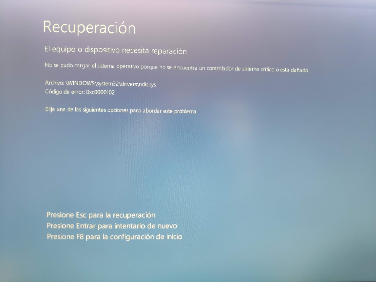

    As far as I know it disables the automatic startup repair feature. The command was run successfully and I rebooted. This time there was no "attempting repairs..." loop, but instead I got this blue screen: I got told that I'd probably get an error while running that command it's in Spanish, translation below
    Windows 10 is stuck in "Attempting repairs..." screen when booting up 1adad106-aa01-401d-8cdb-b760cb035267?upload=true.jpg
    Translation:
    "Recovery
    The system needs recovery
    The operating system couldn't be loaded because it can't find a critical system driver or it's damaged.
    File: \Windows\system32\drivers\ndis.sys
    Error code: 0xc0000102
    Choose one of the following options to adress this issue:
    Press ESC for recovery
    Press ENTER to try again
    Press F8 for startup configuration"
    Looks like an important issue. What should I do now? Can this be solved without losing my files? Thank you in advance, I'd appreciate any help.
