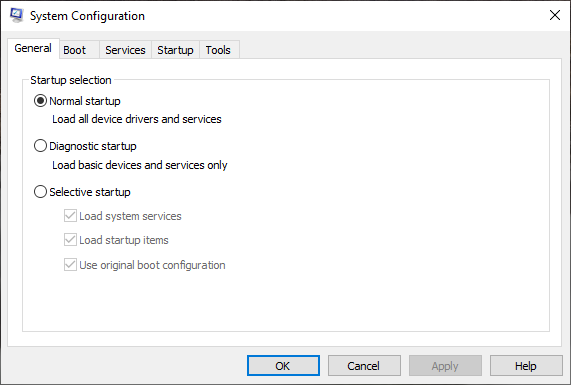

  3. what's the problem switching selective to normal startup?
    see right here, before I selected normal startup, it was on selective startup.
    When I changed to normal startup I got the bsod 0xc000000e winload.exe error, and no boot.
    Had to load the RE off flash and run commands to fixmbr and rebuildbcd.
    Is it just my PC like that?
    I just looked at another of my pc, and it is also on selective startup. If I switch to normal will it crash the boot?
    How about if i return from normal to selective startup on the PC I had to repair the boot, will it again crash?
    The point is I should have been able to do a selective startup. It kept refusing to go back to checking selective startup, every boot would switch back to normal. So what finally killed it it was selecting diagnostic startup then check selective startup and uncheck load startup items and deleting NGC folder
    video here, there was nothing I could do, so I recloned the SSD, a clone is an image. I keep it for just such an emergency.
    Shared album - Scott Downey - Google Photos
    I had followed some instruction to boot Hiram's CD, and was able to run msconfig and switch back to normal, but I had also before that delegeted the NGC folder which holds PIN info.
    After that I had no PIN (was unavailable), and clicking the button below my name in the message tried to open the app store. Which may make some sense to what happened.
