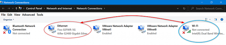

    How to connect to an existing wifi network?
    Not connected for the Wi-Fi indicates it is enabled, but not in use, i.e "connected". As a test, if you disable the ethernet adapter, the Wi-Fi should automatically "connect" and become active, and show in the list. Try that and see what happens.
    Example on mine....

    'Not connected' doesn't necessarily mean the WiFi adapter isn't working, just that you have not yet connected to an available network. If it is working then a list of available WiFi names should appear when you click on the WiFi icon on the taskbar which looks like this
    Windows 10 not showing new wifi networks. It can connect to existing network 269067d1583286072t-how-connect-existing-wifi-network-image.png
    when not connected.
    If the list is empty then either the antenna is not connected to the WiFi adapter or the adapter isn't working. This may be a driver problem rather than hardware, so look in Device Manager for any yellow warnings. Also check that the WiFi adapter is not disable in Device Manager.
