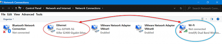

    How to connect to an existing wifi network?
    Not connected for the Wi-Fi indicates it is enabled, but not in use, i.e "connected". As a test, if you disable the ethernet adapter, the Wi-Fi should automatically "connect" and become active, and show in the list. Try that and see what happens.
    Example on mine....
    Windows 10 not showing new wifi networks. It can connect to existing network 269066d1583285966t-how-connect-existing-wifi-network-2020-03-03_20h37_00.png
    f14tomcat, Apr 11, 2023
