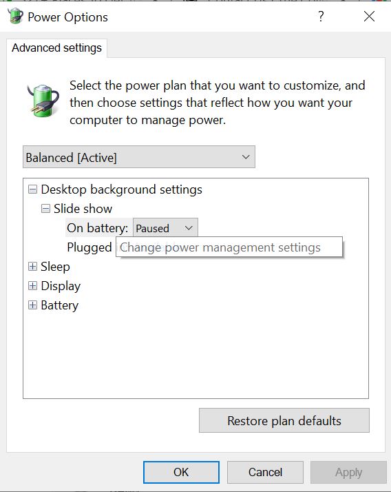

    Hi
    I have been missing power options for a long time and only have "Balanced" available
    I have tried every "fix" found in this post: https://appuals.com/how-to-restore-missing-power-plan-options-on-windows-10/
    None of them have worked.
    Windows 10 - Power plans missing after trying every "fix" 64431e3f-933d-4f6a-83e5-33845f8403c3?upload=true.jpg
    I am missing a lot of options under advanced battery options aswell.
    I have tried to install the .Pow files, loading them in command prompt and fixing the registry editor. None worked.
    Even the "Hack" with windows mobility center does not work..
    I am running Windows 10 Version 2004 on a Microsoft Surface Laptop 3. The reason I need to fix my battery setting is because I am having issues with the network card intel ax201 that turns off after 15 minutes throughout the day and you have to reset network in order for it to work again. I have also tried installing all the newest driver for Surface Laptop 3 & downloaded the latest intel drivers.
    Please assist...

  4. Windows 10 - Power plans missing after trying every "fix"
    Power Plans missing
    FIX for -- Disk usage 100% & Missing High Performance plan - Fixed
    After trying to get to the power settings through Control Panel, Cortana and random other routes to power settings. Would only list Balanced Power Option. Did some more googling found this on another website, it worked. Why this worked and the other routes
    didn't?? I have no idea, but this gave me the fix to the problem. Hope it helps out!
    Open Run --- (Window Button + R)
    Copy and paste this powercfg.cpl
    When the window opens look to the left column.
    Click "Create a power plan"
    You'll now see
    three
    options instead of just the one.
    -Balanced
    -Power Saving
    -High Performance
    Click the bubble for
    High Performance
    Click Next
    Select
    My Custom Plan 1
    FIXED!
    Open Task Manager.. Disk is now 2% etc
    Krispy_Bentley, Dec 2, 2020
