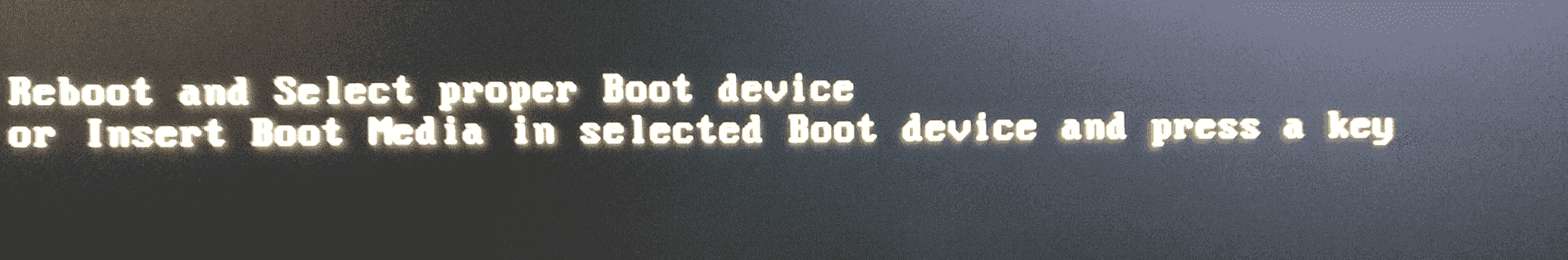

    I'd say maybe once a month or once every few months when I install a Windows update or if my computer crashes, I'll hit the restart button and I'll be greeted with a black screen with white text that says:
    "Reboot and Select proper Boot device or Insert Boot Media in selected Boot device and press a key"
    Windows 10 - Reboot and Select proper Boot device. 1835fcd8-5de4-439b-b43a-5c53913d9e99?upload=true.png
    This has been happening for about a year and a half.
    If I hit the power button and power back on again I can boot into Windows normally - reset won't work though.
    Is this something I should be concerned about or It's just a standard crash message?
    Also, I have to say, I kinda feel like my SSD (where Windows is stored) has been kinda slow/sluggish. I checked it in CrystalDisk and it says It's fine. But sometimes It's really slow to access information from my desktop/recycling big and else where. This crash happened when I was trying to delete 110 GB with thousands of small files in the folder. It's just real slow at deleting stuff sometimes.
    From reading around on various forums people have suggested the following:
    -Try disabling hybrid sleep mode
    -SATA cable issue or if the BIOS has it, add a boot delay.
    -Check BIOS to see if your SSD is showing. Change SATA cable and plug it into
    a different SSD port on your motherboard. If it still doesn't recognize it in
    your BIOS, your SSD is toast.
    What do you guys recommend?

    Hello all. Getting a little frustrated here. A couple of weeks ago we had a user come in on a Monday morning to find that her pc was displaying the classic message "Reboot and select proper boot device...". Tried popping in a windows disk and fixing the MBR, no luck. Ended up reinstalling windows and her few programs back on it. All was good after this. For about a day. She came in the next day to find the same message. So at that point we decided that more than likely the drive was bad even though oddly enough it tested out fine. It was a Corsair 60gb SSD.
    Last week we swapped that Corsair with a 64gb Crucial SSD and installed Windows. We then created a backup image of that drive. All was good until Thursday when her power strip that the PC was plugged into got tripped. Start up the computer for find "Reboot and select proper boot device..." message. So, apply the backed up image to the SSD since repairing the MBR didn't work.
    Now this morning she comes in and the PC is running fine. Attempts to open Microsoft Word and she gets a pop-up stating there isn't enough disk space. So, she then restarts and upon booting back up gets "Reboot and select proper boot device..."
    Any ideas what is causing this? Is it something with the mobo or do I just have horrible luck and replaced the bad SSD with another bad SSD?

    cmos battery, or bios chip is screwed up
