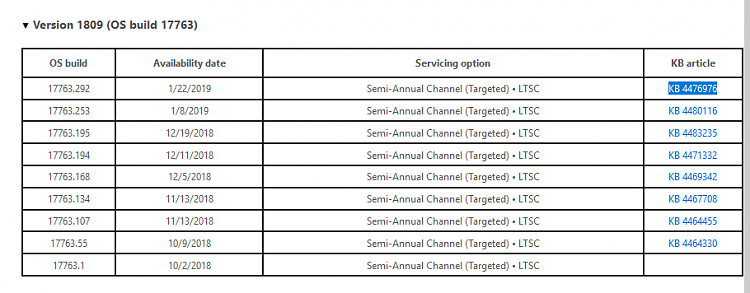

    2. Check if there is a higher update available e.g (Version 1809 OS Build 17763.292)
    You can do this here HTML Code: 3. Click on the KB article that is relevant to you.

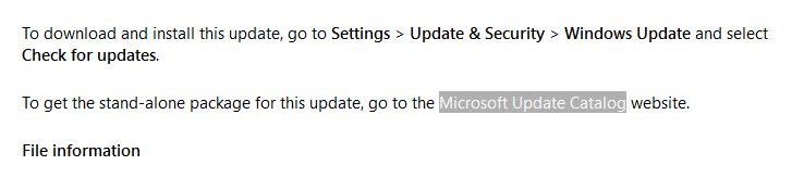

    4. Scroll to the bottom and download the standalone update by clicking on Microsoft Update Catalog.

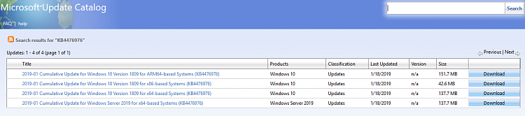

    5. Download the correct system architecture.
    Windows 10 settings app closes almost instantly after opening it 223978d1549844086t-settings-metro-app-instantly-closes-cant-diagnose-issue-updates.png
    Install and this should resolve your problems - if it does (CREATE A NEW SYSTEM RESTORE POINT)
