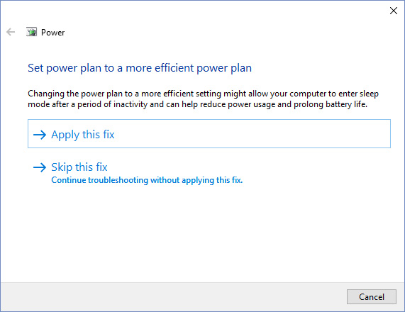

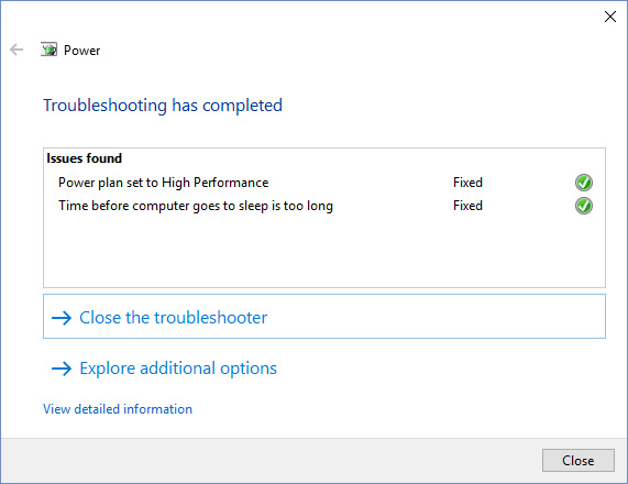

    I ran the Control Panel "Troubleshoot problems" feature (Control Panel\All Control Panel Items\Troubleshooting\System and Security: Power). The troubleshooter runs and displays:
    Windows 10 Sleep settings ignored, goes to sleep after two minutes f3bb167b-aac5-4a2b-95ed-d6c425132f11.jpg
    Then:
    Windows 10 Sleep settings ignored, goes to sleep after two minutes 93be3632-9802-4c45-b5fc-3c917a6f1917.jpg
    What actually happened:
    • Power plan was changed from "High performance" to "Balanced (recommended)" *Troubleshooter message says the opposite.
      • On Battery:
        • Sleep after 30 minutes changed to 15 minutes.
      • Plugged in:
        • Sleep after 1 hour changed to 30 minutes.
    The troubleshooter stated "Time before computer goes to sleep is too long" so why do the dropdowns allow for up to 5 hours? Why, when I make any allowable change does the sleep settings default to 2 minutes regardless of the setting? Also, why does Microsoft
    offer multiple power plans and configuration options when they are just going to force you to "Use a more efficient plan"?
    I have had Windows 10 for 6+ months now. This issue just started happening a couple of weeks ago. Nothing but Windows updates have been installed since before this started happening.
