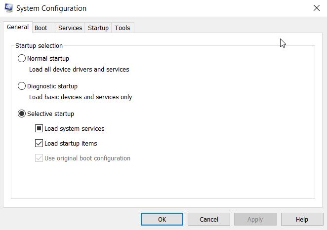

    System Configuration Utility, popularly known as MSCONFIG, allows you to configure the startup behavior of Windows. It allows users to troubleshoot the load time, stability, and performance problems. It has been reported that Windows 10 gets stuck in Selective Startup, which means few things will never load as the computer starts. If you are facing this issue, then this post may be able to help you resolve the problem.

    MSConfig offers three modes—
    1. Normal startup,
    2. Diagnostic startup, or
    3. Selective startup.
    When Windows gets stuck in selective startup, then even when you select the Normal startup option, the option may change to the Selective startup option when you restart your computer.
    Windows 10 stuck in Selective Startup mode in MSCONFIG Selective-Startup-Windows-Stuck-700x422.jpg

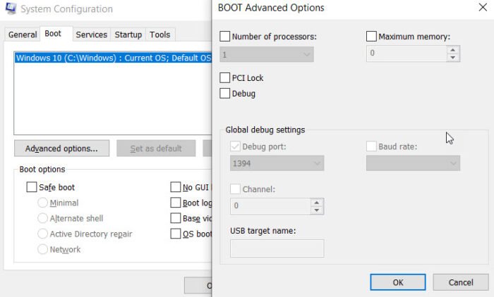

    If Normal startup reverts to Selective startup as MSCONFIG cannot select or save settings after reboot, then try this:
    • Type MSConfig in the Run prompt (Win +R) and press the Enter key.
    • Switch to the Boot tab
    • Click on the Advanced Options button.
    • Clear all the that is selected there
    • Click on the OK button.
    • Restart the computer, and now everything should boot normally.
    Microsoft mentions that the Normal startup option reverts to Selective startup if you select any of the options in the Advanced Boot Settings dialog box in MSCONFIG. This behavior is by design.
    Additionally, if any of the services have been disabled or changed from their default value, the computer will set the startup type as Selective. Switch to the Services tab, and then check if you have anything disabled, enable it.
    Selective Startup is not a bad thing. Most of the time, many services start as the computer starts, and this diminishes the system performance. It helps you troubleshoot. If you are facing a problem, you may have to go through the list one by one, and check if the particular service or option is disabled or checked, and change it.
