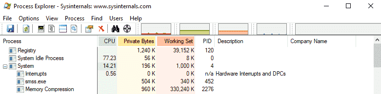

Discus and support Windows 10 System CPU usage after 4 minutes of idle in Windows 10 BSOD Crashes and Debugging to solve the problem; What is System doing? Why does this not show up in Task Manager? Why does Task Manager consistently fail to display accurate per-process CPU usage?... Discussion in 'Windows 10 BSOD Crashes and Debugging' started by ForrestBarnes, Oct 18, 2018.
  1. Windows 10 System CPU usage after 4 minutes of idle
    1. What is System doing?
    2. Why does this not show up in Task Manager?
      1. Why does Task Manager consistently fail to display accurate per-process CPU usage?
    Windows 10 System CPU usage after 4 minutes of idle 9c21b124-794b-421b-a20c-1571dcc30427?upload=true.png
  2. How fix 4-times-higher CPU usage at idle?

    After the Windows 10 Anniversary Update, the 39% CPU usage screen shot of my Process Manager was when I was doing nothing--no browsing, word processing, etc. Before I took the screen shots, I closed all application programs. My machine was leveled out, as you better describe it (the screen shots were taken 5 minutes after my PC first leveled out). My PC is 39% CPU usage when leveled out; never lower.
    Before the Windows 10 Anniversary Update, my PC was 10% CPU usage when it leveled out. And it stayed there.
    1 other PC we have with the Windows 10 Anniversary Update (same model as my PC) *HAS* the 39%-CPU-usage-at-idle problem.
    2 other PCs we have with the Windows 10 Anniversary Update (different brands) DO *NOT* HAVE the 39%-CPU-usage-at-idle problem. They have only 10% CPU usage at idle.
