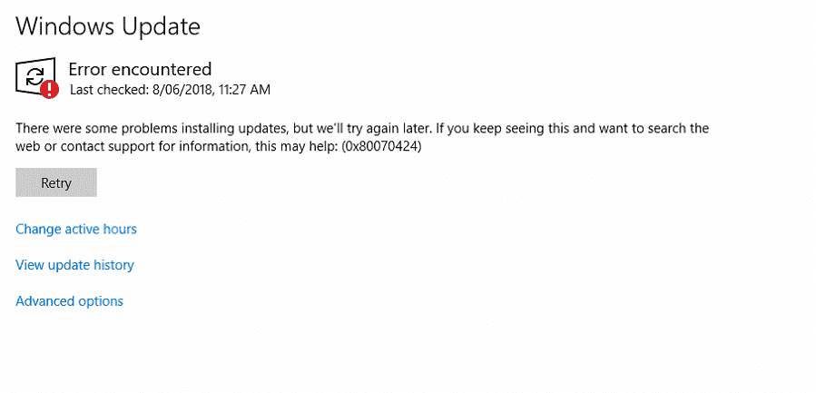

    Hi There,
    When trying to update my computer I get the following error:
    Windows 10 update service missing and unable to update (0x80070424) b0c6df46-313f-4cc5-966d-d5a536993fb0?upload=true.png
    When looking for the Windows Update service I can see it's missing:
    Windows 10 update service missing and unable to update (0x80070424) c83a0384-a7b5-4ae2-b772-0aa7785930dc?upload=true.png
    The Medic Service wasn't running either but I have since turned this on.
    I have tried the remediation steps detailed in the following article:
    https://answers.microsoft.com/en-us/windows/forum/windows_10-update-winpc/windows-10-update-service-missing-and-unable-to/cb4e347b-3028-4f02-808e-8dc4dde6e09d?auth=1
    However these have not worked - all completed successfully and after restarting there is still no service and I receive the same error.
    Running Win10 Pro 64bit.
    Thanks
    Dave
    dasforsyth_628, Aug 5, 2018

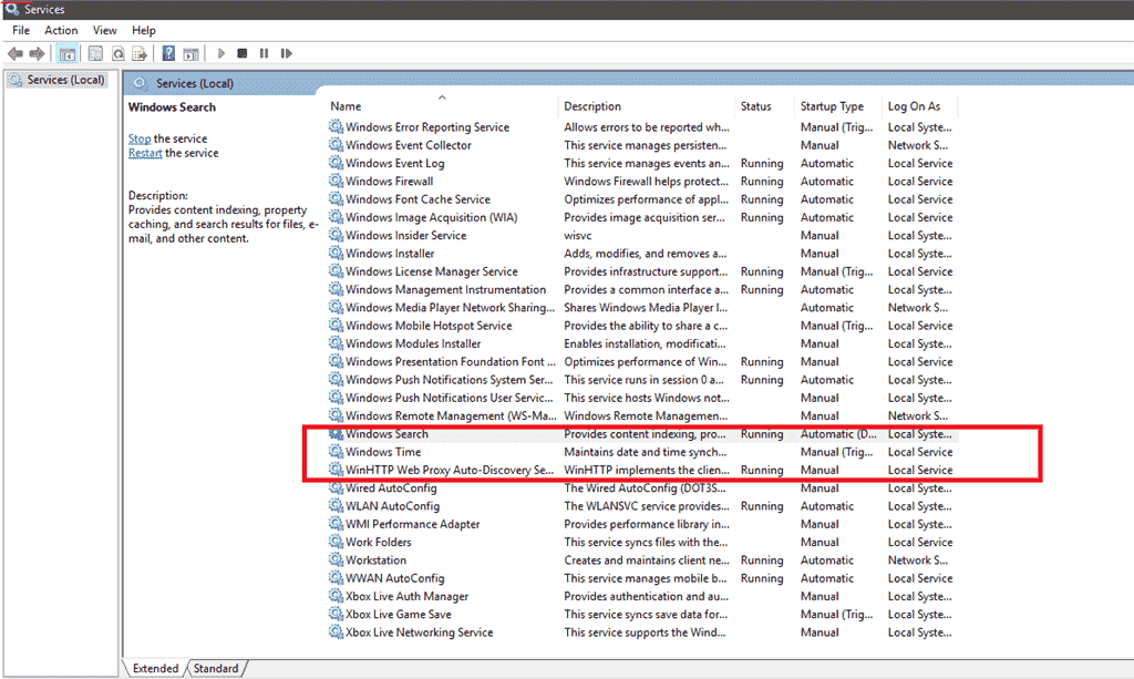

  2. g4force28 Win User
    windows 10 update service missing and unable to update (0x80070424)
    windows 10 update service missing from the services -
    Windows 10 update service missing and unable to update (0x80070424) 29c34fb1-6521-4aff-8548-fa7472fde658.png
    And unable to update windows 10-
    There were some problems installing updates, but we'll try again later. If you keep seeing this and want to search the web or contact support for information, this may help: (0x80070424)
    For the info I tried the most of the online solutions... nothing works.
    BITS service is running and in registry Windows update components are missing.
    g4force28, Aug 5, 2018

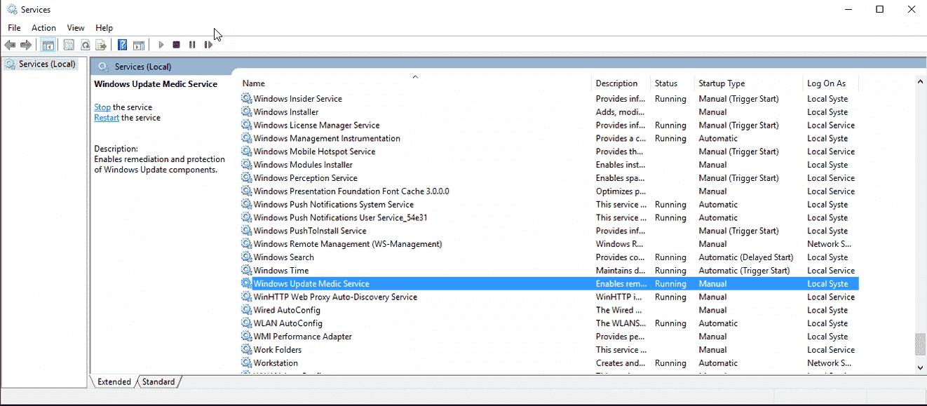

  3. kambei.7s Win User
    Windows 10 Update Orchestrator Service
    found similar error in the 'System' log, during the restart after installing the update, is this normal for windows 10? Does everyone faced such thing? The update seems to have settled, in the status I've see 'Success', there seem to be no other errors.
    The "Update Orchestrator Service" service is turned off due to an error
    The return from the operation was due to the timeout.
    code 7023 source of Service Control Manager
    EventData
    param1 Update Orchestrator Service
    param2 %% 2147549471
    550073006F005300760063000000
    Keywords 0x8080000000000000
    after 20 seconds
    The C: \ Windows \ system32 \ MusNotificationUX.exe process initiated the "Restart" action for the DESKTOP computer on behalf of the user due to: Operating system: Service pack installation Scheduled
    The update was installed
    KB4103727 OS Build 16299.431
    Thanks.
