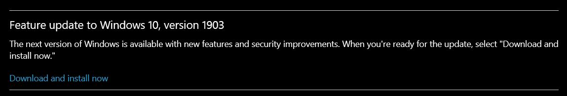

  4. Windows 10 upgrade from v1803 to v1903 - Failed multiple times after attempting various options
    Upgrading to Windows 10 v1903 from v1809
    Hi all,
    I got my new Acer Nitro 5 AN515-42 laptop which i got Windows 10 v1803 pre-installed. Out of curiosity i updated my windows forcefully to v1903 and lost my WiFi connectivity. I tried rolling back drivers and all the troubleshooting steps from various sites
    and it didn't help me.
    On checking known issues for Windows 10 v1903 there is a issue with previous generation Qualcomm WiFi network cards. (Link: Windows 10, version 1903 and Windows Server, version 1903 - Windows Release Information )
    I reinstalled my Windows 10 and downgraded to v1809 and everything works fine. From today
    (29th May 2019) i started getting a notification in my windows update page that my PC is ready to upgrade to v1903.
    Windows 10 upgrade from v1803 to v1903 - Failed multiple times after attempting various options 0c10afc3-fa46-4b52-87d5-9c32e93d7e19?upload=true.jpg
    Should i go ahead and take the risk of updating or should i wait for more days before i get this updated?.
    Hardware Details:
    Network Card: Qualcomm Atheros QCA61x4A Wireless Network Adapter
    Hardware ID: PCI\VEN_168C&DEV_003E&SUBSYS_080711AD
    Any suggestions / solutions would be appreciated.
    Thanks
    Sankar R
    ramsankar0206, Sep 8, 2019
