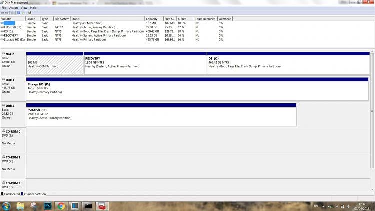

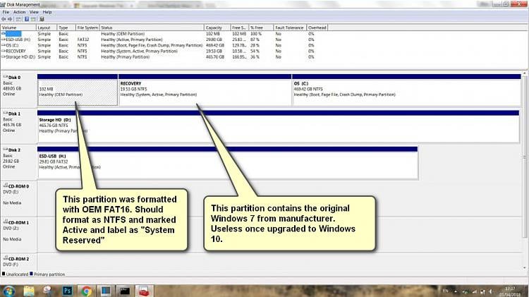

    Upgrade Windows 7 to 10 Error 0x8007001f
    Windows 10 upgrade stops at 35%.   Gives error 0x8007001f.  Need help. 183140d1522615083t-upgrade-windows-7-10-error-0x8007001f-disk-management.jpg
    The partition layout of disk 0 (shown as disk 1 in Partition Manager) is non standard and was customized by the manufacturer. A normal Win 7 installation will have a layout:
    1. 100MB System Reserved, NTFS format and marked as Active
    2. C drive.
    A normal Windows 10 installation will have:
    1. 550MB Reserved partition, NTFS format and marked as Active
    2. C drive.
    Since you know how to use Minitool Partition Manager. Suggest to use it:
    1. Create a bootable installation USB from the Windows ISO using: Rufus - Create bootable USB drives the easy way
    2. Delete the 1st 2 partitions (102MB, 15GB) then create a 550MB partition, format as NTFS, label "System Reserved", assign a letter R, mark as Active
    3. Move C drive next to the newly created 550MB. should look like the screen shot below, note H: drive should be C: in your case:
      Windows 10 upgrade stops at 35%.   Gives error 0x8007001f.  Need help. 183142d1522615995t-upgrade-windows-7-10-error-0x8007001f-p2.jpg
    4. Boot up the USB created in step 1, on the first screen, press SHIFT+F10 to open the Admin command prompt then type:
      bcdboot C:\Windows /s R: /f BIOS =====> This will create the BCD to boot Windows and store in R: (550MB partition)
    5. Reboot the PC then try to upgrade again
    NOTE: It is advisable to create a backup image of the whole disk 0, just in case anything goes wrong then you can restore back before making any modification.

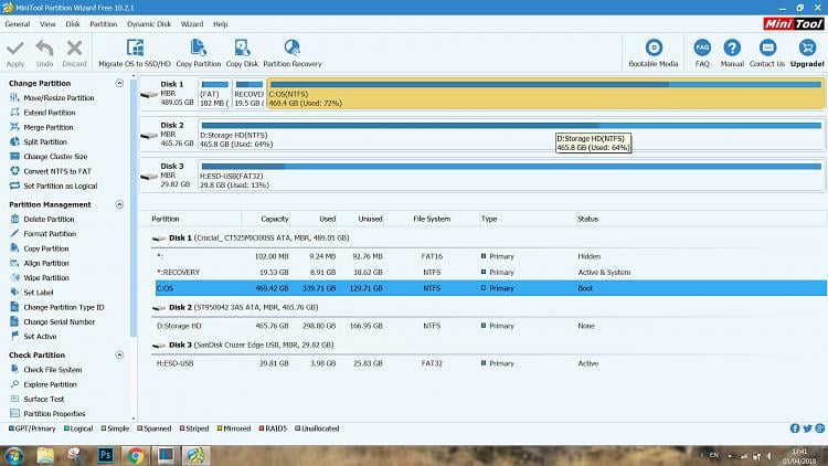

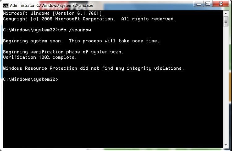

  3. ned14 Win User
    Screenshots of partitions and sfc/scannow results.
    Windows 10 upgrade stops at 35%.   Gives error 0x8007001f.  Need help. 183122d1522600959t-upgrade-windows-7-10-error-0x8007001f-disk-management.jpg
    Windows 10 upgrade stops at 35%.   Gives error 0x8007001f.  Need help. 183123d1522600959t-upgrade-windows-7-10-error-0x8007001f-minitool.jpg
    Windows 10 upgrade stops at 35%.   Gives error 0x8007001f.  Need help. 183124d1522600959t-upgrade-windows-7-10-error-0x8007001f-scannow.jpg
