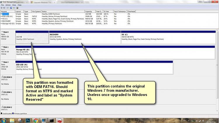

    Windows 10 upgrade stops at 35%.   Gives error 0x8007001f.  Need help. 183140d1522615083t-upgrade-windows-7-10-error-0x8007001f-disk-management.jpg
    The partition layout of disk 0 (shown as disk 1 in Partition Manager) is non standard and was customized by the manufacturer. A normal Win 7 installation will have a layout:
    1. 100MB System Reserved, NTFS format and marked as Active
    2. C drive.
    A normal Windows 10 installation will have:
    1. 550MB Reserved partition, NTFS format and marked as Active
    2. C drive.
    Since you know how to use Minitool Partition Manager. Suggest to use it:
    1. Create a bootable installation USB from the Windows ISO using: Rufus - Create bootable USB drives the easy way
    2. Delete the 1st 2 partitions (102MB, 15GB) then create a 550MB partition, format as NTFS, label "System Reserved", assign a letter R, mark as Active
    3. Move C drive next to the newly created 550MB. should look like the screen shot below, note H: drive should be C: in your case:
      Windows 10 upgrade stops at 35%.   Gives error 0x8007001f.  Need help. 183142d1522615995t-upgrade-windows-7-10-error-0x8007001f-p2.jpg
    4. Boot up the USB created in step 1, on the first screen, press SHIFT+F10 to open the Admin command prompt then type:
      bcdboot C:\Windows /s R: /f BIOS =====> This will create the BCD to boot Windows and store in R: (550MB partition)
    5. Reboot the PC then try to upgrade again
    NOTE: It is advisable to create a backup image of the whole disk 0, just in case anything goes wrong then you can restore back before making any modification.
    To create a backup image Use:
    Macrium Reflect Free Edition x64
    Macrium Reflect Free Edition x86
    topgundcp, Oct 10, 2023

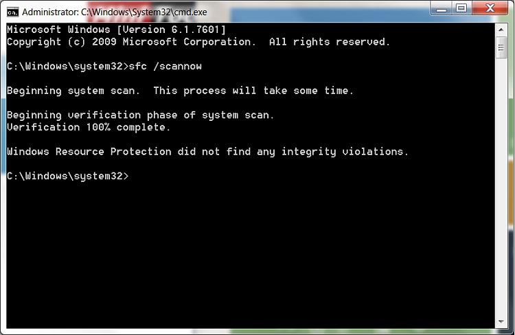

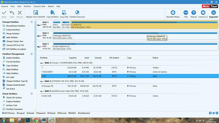

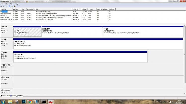

    Screenshots of partitions and sfc/scannow results.
    Windows 10 upgrade stops at 35%.   Gives error 0x8007001f.  Need help. 183122d1522600959t-upgrade-windows-7-10-error-0x8007001f-disk-management.jpg
    Windows 10 upgrade stops at 35%.   Gives error 0x8007001f.  Need help. 183123d1522600959t-upgrade-windows-7-10-error-0x8007001f-minitool.jpg
    Windows 10 upgrade stops at 35%.   Gives error 0x8007001f.  Need help. 183124d1522600959t-upgrade-windows-7-10-error-0x8007001f-scannow.jpg
    ned14, Oct 10, 2023
