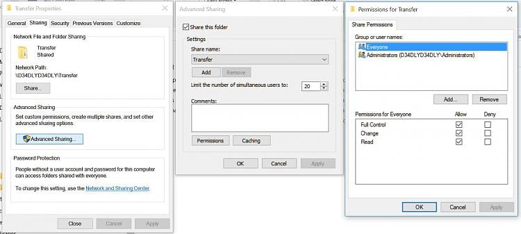

    I have a new Windows 10 Home computer and I've selected a folder and shared it. I've added Everyone to the Share Permissions list with Full Control.
    Windows 10 user not prompted for login credentials on access to shared folder on server. 485956594t-win-10-pc-accessing-win-10-everyone-share-prompted-credentials-shared-folder-settings.jpg

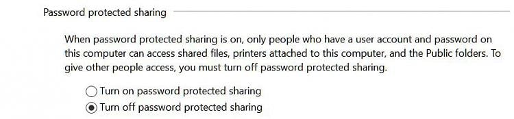

    I've selected "Turn off password protected sharing" in the Advance Sharing Center.
    Windows 10 user not prompted for login credentials on access to shared folder on server. 56594t-win-10-pc-accessing-win-10-everyone-share-prompted-credentials-password-protected-sharing.jpg

  3. Win 10 PC accessing a Win 10 Everyone share prompted for credentials
    Here is the solution for this issue :
    1 Right click on the folder that you want to share
    2. Go to Properties
    3. Go to Security Tab then click Edit on group and usernames
    4. Click Add and on the user and group window click advance
    5. Click Find Now and look for Everyone on the Search results, Click OK to close the window and OK again
    6. Give the control you need for Everyone and click "OK"
    That should make that folder accessible without prompting for windows credentials Windows 10 user not prompted for login credentials on access to shared folder on server. :)
