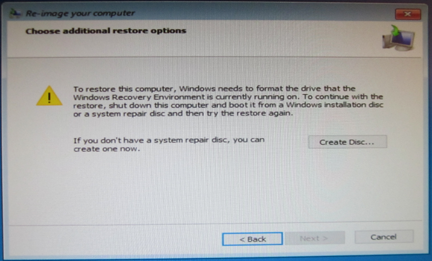

    On the other side of the coin, the RMB not set can cause a different problem when the windows installation media is used for recovery. IE: To restore a windows image from a previous backup when a reformat of the volumes is needed.
    In that case you get the message in the picture below based on the assumption that the recovery is running from the internal recovery volume. I think is the wrong assumption in this case because the boot was already done from the external USB device with Windows Installation media. In this case the missing RMB on the USB device causes this confusion.
    Note that if the reformat is not needed the restore proceeds normally to completion.
    Using the Windows installation media on a USB device that shows as "Removable" eliminates this problem and the restore works fine.
    Windows 10 v1903 different behavior of USB installation media , Basic versus Removable (RMB) e41af6e1-fdb6-4325-8ff7-e0809ddf1d55?upload=true.png
