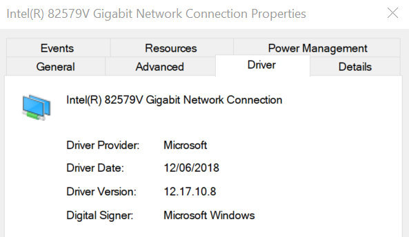

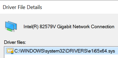

    After logging in, I have ethernet connection straight away, and all is fine. For reference, the driver loaded for this device "IntelR 82579V Gigabit Network Connection" is thus:
    Windows 10 Version 2004 - Intel 82579V Gigabit Network Connection not immediately loading... 9be1f19a-7bcd-47be-b315-83b28a522f78?upload=true.png
    Windows 10 Version 2004 - Intel 82579V Gigabit Network Connection not immediately loading... 8ccd6509-2c74-437c-ab80-c476ee48e275?upload=true.png This appears to be the driver downloaded from windows update automatically.
