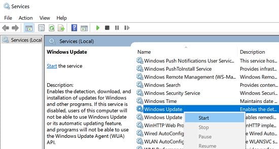

    Then I ran across an easy to implement series of steps (that I felt would not corrupt my current install.
    These steps were:
    1. Go to the Windows search bar and type services.
    2. Double-click on the Services app and scroll down to Windows Update.
      Windows 10 version 20H2 to upgrade to 21H1 fails at 70% restart-windows-update-service.jpg
    3. If the service is already running, right-click on it and select Stop. Then restart it.
    4. If the service is disabled, right-click on it and select Start.
    5. Additionally, make sure the Background Intelligent Transfer Service and Cryptographic Service are running.
    I made sure these 3 services were running and then restarted each of them.
    Rebooted the computer and ran the Windows 10 update assistant again. This time the update completed successfully and I am now running 21H1. I do not know if it was the USB driver upgrade or the services resets that corrected the problem but each were painless to implement.
