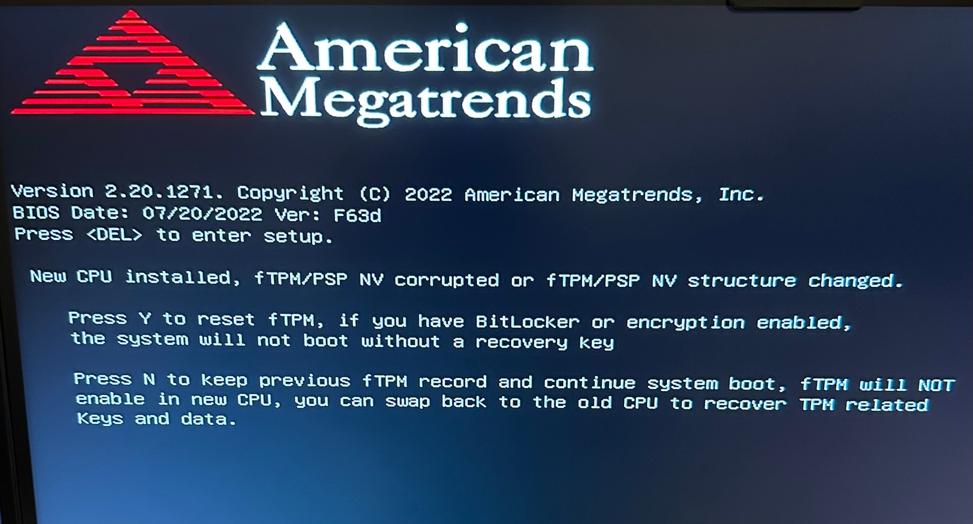

    Dear Microsoft Community,
    Situation:
    • I recently replaced my old CPU (Ryzen 5 2600) with a Ryzen 5 5600, see system information below
    • Failed to consider that TPM was activated; I did not use TPM for BitLocker/drive encryption
    The first boot up showed the following message:
    windows 11 activation with TPM feature disable 90d50530-7646-4f26-9dc1-a3625f2b6f95?upload=true.jpg
    Initially, I pressed N, which resulted in a re-boot that left me with the same message. Then, I followed the recommendation stated in several online forums and pressed Y (important to note: Z on a German keyboard). This was succeded by a seemingly normal system boot into Windows 11 - all files are (afaik) accessible.
    Problem:
    Checking the system security reveals that the status for "Nachweis" (~ verification) is "Nicht unterstützt" (not supported), see image below.
    windows 11 activation with TPM feature disable 41d10c7b-78fa-468a-b411-87247f4a27a6?upload=true.png
    Updating the drivers via device manager did not solve the issue.
    Questions:
    • How do I get TPM to correctly work again? I have not yet tried to remove TPM.
    • Can I safely sell / pass on my old CPU even though it was removed with an active TPM?
