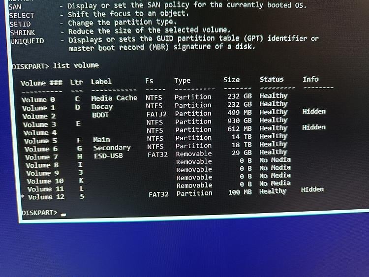

  3. Non-destructively Moving / recreating EFI partition
    hello - I'm getting to the last step here and when I do the command bcdboot E:\windows /s S: it just returns a list of diskpart commands. E is the 930GB NTFS volume that's the main partition on the 1TB drive. The BOOT partition doesn't have a letter assigned to it. The new EFI 100MB partiton is volume 12 / letter S. I can't see how to post a pic on my phone here but will try on my laptop so you can see the full volume list thanks! - - - Updated - - -
    Windows 11 Boot EFI partition replacement / recreation 397902d1695375687t-non-destructively-moving-recreating-efi-partition-img20230922101603-2.jpg
