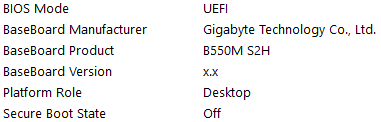

    My system uses UEFI and is booted using UEFI. It used to have CSM support enabled alongside UEFI but I disabled CSM support in order to enable Secure Boot. I also have successfully installed Windows 11 about a few weeks ago with no issues. I just need to enable secure boot as that is a requirement for several anti-cheat programs.
    Windows was also installed using the GPT scheme and I know that my motherboard supports secure boot, just that when I enable it it'll get stuck in a Windows automatic repair loop.
    Windows 11 boot stuck after disable CSM and enable Security boot already in gpt aa0ea2a0-99bd-4b04-819a-4a163831cf7d?upload=true.png
    Thanks.
    Default__531, Dec 10, 2022
