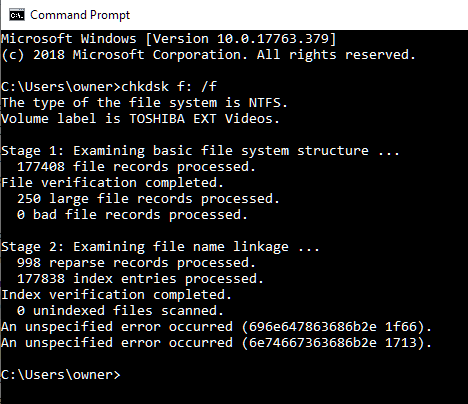

  4. Bree Win User
    windows 11 chkdsk - An unspecified error occured in stage 2
    CHKDSK /F fails with An unspecified error occurred.
    I decided to run chkdsk /f on a 1TB external usb HDD. It failed with:
    An unspecified error occurred (696e647863686b2e 1f66).
    An unspecified error occurred (6e74667363686b2e 1713).
    windows 11 chkdsk - An unspecified error occured in stage 2 227482d1552705325t-chkdsk-f-fails-unspecified-error-occurred-chkdsk-w10-1809.png

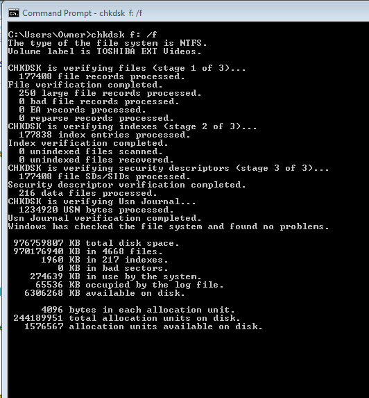

    ....then I tried another known good external HDD, same error. Then I tried an internal partition, same error. Then I freshly formatted a usb flash drive as ntfs and checked it, same error.
    Then I tried three different PCs, 1809 17763.379 (x86 and x64) and 1803 17134.648 (x86). All failed a chkdsk /f with an unspecified error on any ntfs drive I checked.
    Then I tried Windows 7 and it passed the drives with a clean bill of health!
    windows 11 chkdsk - An unspecified error occured in stage 2 227483d1552705403t-chkdsk-f-fails-unspecified-error-occurred-chkdsk-w7.png
    Is it me, or is Windows 10's chkdsk /f broken as far as ntfs is concerned?
    PS: chkdsk WITHOUT the /f runs fine in Windows 10 on all the drives and says they are healthy.
    Bree, Sep 9, 2023
