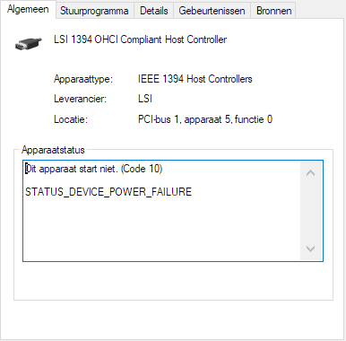

    Hi, I need help to solve an issue I have with my LSI 1394 OHCI Compliant Host Controller.
    I noticed an exclamation mark in Device Manager next to my 1394 Host Controller and despite turning 1394 off in my BIOS it keeps coming back. I've also tried to disable and uninstall this device in Device Manager, with the same result, and when I try to update it I get an error (see screenshots below).

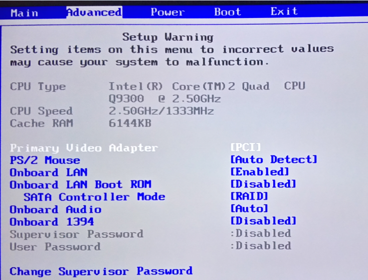

    First screenshot, 1394 disabled in BIOS (American Megatrends 5.43).
    Windows 11 does not update the '1394 OHCI Compliant Host Controller' driver 178765d1519754110t-lsi-1394-ohci-compliant-host-controller-screenshot-bios.png

    Third screenshot, error Code 10, Device doesn't start, STATUS_DEVICE_POWER_FAILURE.

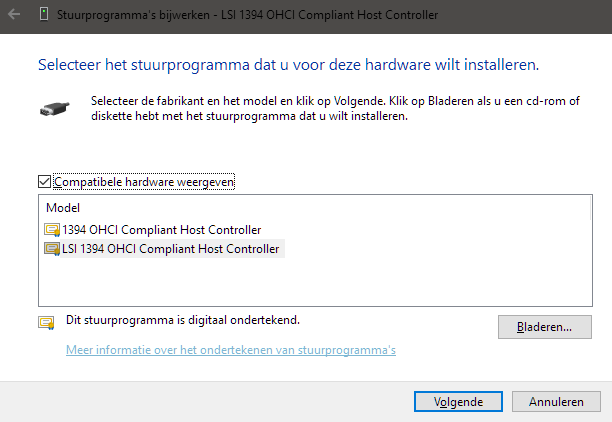

    The following screenshot is taken when trying to update 1394 manually and selecting LSI 1394 [...]
    Windows 11 does not update the '1394 OHCI Compliant Host Controller' driver 178768d1519754254t-lsi-1394-ohci-compliant-host-controller-1394b.png

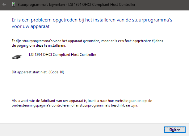

    My final screenshot is another error message of the subsequent page in the update process.
    Translated from Dutch it says, A problem occurred installing driver files for your device.
    Driver files have been found but an error occurred trying to install them.
    Windows 11 does not update the '1394 OHCI Compliant Host Controller' driver 178771d1519754286t-lsi-1394-ohci-compliant-host-controller-1394c.png
    Device doesn't start (Code 10). If you know who the manufacturer is of your device, you can visit their website support section to check if there are device driver updates available.
    Don't know what the cause is.
    My PC is up-to-date (OS, Drivers, important software) and otherwise i don't experience problems.
    Tho I find it peculiar to see an error in Device Manager when that particular device is deliberately turned off in my BIOS. And before you ask, yes when I turn 1394 On in my BIOS I experience the same issue...

    First Enable 1394 in the Bios. Boot into Windows and Go to the Device Manager, expand IEEE 1394 and right click the LSI device and choose Update Driver. Choose Browse my computer for driver software. Choose Let Me Pick from a list. Choose the 1394 OHCI compliant Host Controller instead of the LSI choose Next.

    If I'm not mistaken I already tried this method, but just to double check I'll give it another try...
