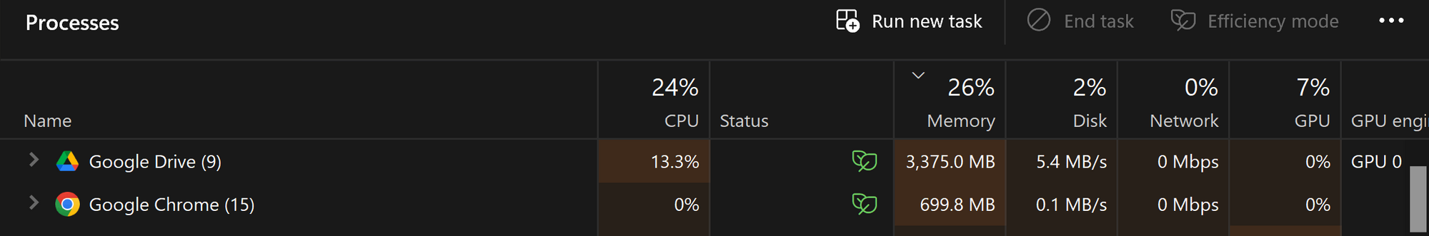

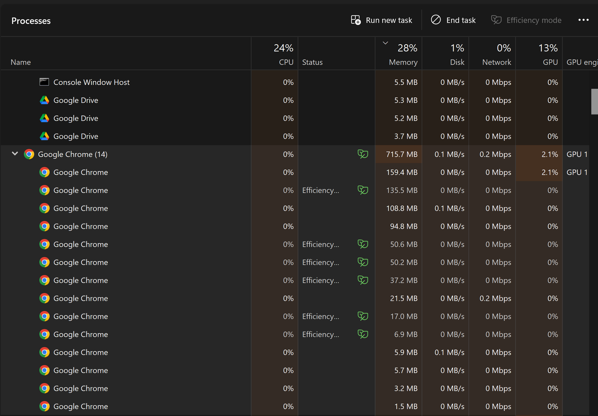

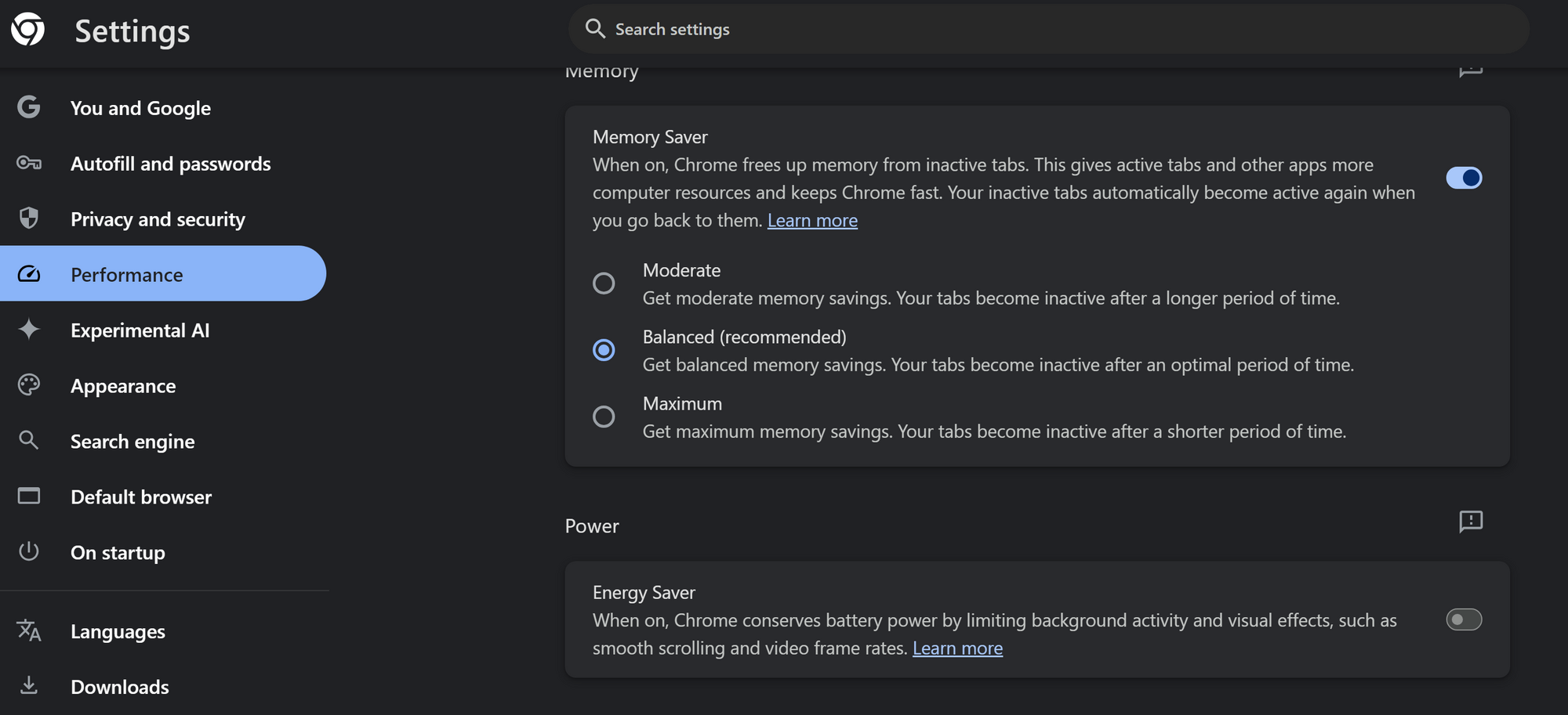

  4. HRody Win User
    Windows 11 efficiency mode causing issues with Outlook
    Efficiency mode causing performance issue
    I am running:
    OS Name Microsoft Windows 11 Pro
    Version 10.0.22635 Build 22635
    I performed/verified the following:
    • Power Plan Settings:
      • Go to 'Settings' > 'System' > 'Power & battery'.
      • Under 'Power mode', make sure it's set to 'Best performance'.
    • Graphics Settings:
      • Go to 'Settings' > 'System' > 'Display' > 'Graphics'.
      • Browse for the AutoCAD Civil 3D executable or add it if it's not listed.
      • Once added, click on the application and choose 'Options'.
      • Set the graphics preference to 'High performance'.
    However, my two applications of interest are Chrome and Google Drive which are in Efficiency Mode as indicated by the Task Manager. I performed the graphics settings verification with Chrome.
    The Registry Key HKEY_LOCAL_MACHINE\SYSTEM\CurrentControlSet\Control\Power\PowerThrottling was not there by default.
    I added the Key, and a DWORD PowerThrottlingOff, and set the value to 1. The machine was rebooted.
    It did NOT turn off Efficiency Mode for these Apps or Processes as suggested, via process inspection in the Task Manager.
    Windows 11 efficiency mode causing issues with Outlook TJjter1AobAasE4VuXcT034EPOSIu%2BfESy0tHxg8xXPglAbvgjoMmRc9CgOqm6z1Wawjb73TQHVvNdrH5Xc35c1Kccc%3D.png
    Windows 11 efficiency mode causing issues with Outlook 7Ii%2BBo9N%2BoqhvD3k5kB9c33QH0BTxHwZnE7h%2BDTuwbKUQvgT6LBYvN63VXrLBwZCYXV90UDiidxFhg%2FDFhjJo%3D.png
    Windows 11 efficiency mode causing issues with Outlook un%2BAG9uMwjG%2BOb8XUvQfaDIrVAx%2Fs38wAKouFSdG%2F2x76KKs8%2BYFUxOE3bgzJwIdDHtyL5yWcbuFe3ifTRk%3D.png
    This calls into question the accuracy of this reply from a "Specialist".
    Regards
    HRody, Dec 6, 2024
